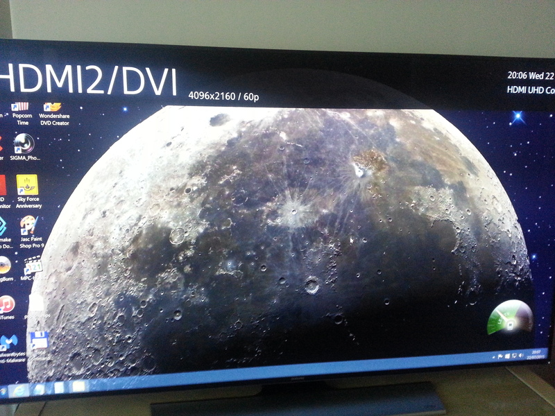

ljw2k 0 Posted August 6, 2015 Hi many thanks and I do not use IR at night and usually leave on day mode as lighting is very good in the street. Interesting about the resolution in screens surely if viewed on a 4k screen would be better than on a standard 720 screen where if the screen was large enough ( Mine is 55" ) you would get the chicken wire effect and see individual pixels if close enough. Share this post Link to post Share on other sites
Boogieman 1 Posted August 6, 2015 ljw2k said: Hi many thanks and I do not use IR at night and usually leave on day mode as lighting is very good in the street.Interesting about the resolution in screens surely if viewed on a 4k screen would be better than on a standard 720 screen where if the screen was large enough ( Mine is 55" ) you would get the chicken wire effect and see individual pixels if close enough. The point is you dont need a 4k screen to take advantage of higher resolution cameras. Share this post Link to post Share on other sites
