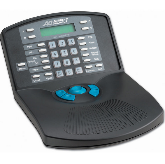

dvrtiger 0 Posted August 6, 2015 Hi to everyone! I have an issue with adtte16e touch tracker v5. After applying power and boot up sequence it displays 'R1' in the upper right corner and I'm unable to control it or to enter menu functions. If someone has a solution, I would appreciate it. Regards Share this post Link to post Share on other sites

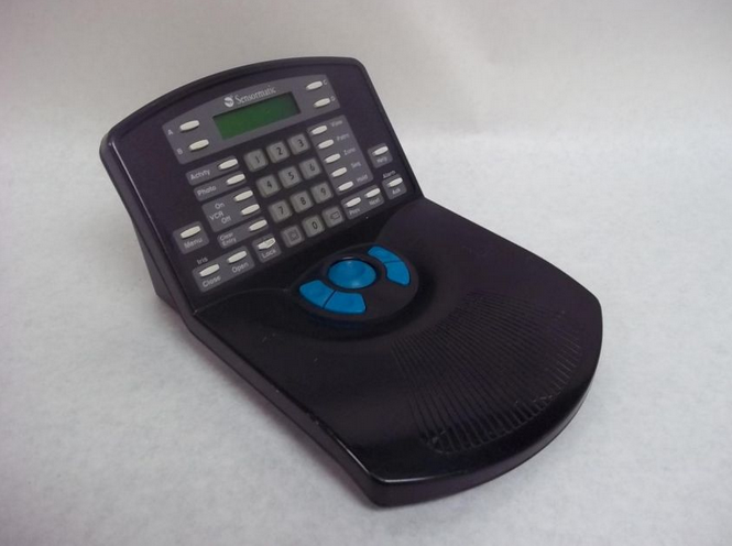

Brenton81 0 Posted August 6, 2015 Sounds like what you actually have is a TouchTracker for a VM96 matrix switcher. It looks very similar to a TouchTracker 16 but it's different and will not work if it's not connected to a VM96. RCTTRKE for the VM96: ADTT16E: Share this post Link to post Share on other sites
dvrtiger 0 Posted August 7, 2015 Thank you for your answer, I'll see to it and try with a matrix. It's been a while since I've worked with them, so I've forgot about it. Share this post Link to post Share on other sites
