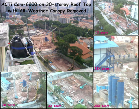

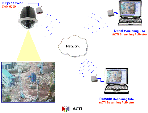

nextan 0 Posted March 22, 2006 Have done a couple of such installation using ACTi's system: http://www.securitypark.co.uk/article.asp?articleid=24744&CategoryID=9 http://www.securitypark.co.uk/article.asp?articleid=24790&CategoryID=1 or from ACTi's site which has some illustrations: http://www.acti.com/Press_RoomV2/News.Asp Particularly for the Pinnacle@Duxton 50-storey apartmentd project, we will be mounting the 2nd camera on the main tower crane which will eventually be raised to 200 meters height. With IP cameras like ACTi's system, you can actually stream live video instead of through a FTP server. IN most of our projects, we require only 128 Kbps to stream a CIF size 5 frames per second live video. If you want to have a feel of the live video streaming from these sites, PM me your email address. Share this post Link to post Share on other sites
