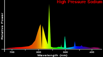

kandcorp 0 Posted March 24, 2006 Any High Pressure Sodium Lamps usually will cause poor color reproduction. Especially with cheap cams. I wonder how the SDIII would do in a warehouse type environment with HPS lamps. Share this post Link to post Share on other sites

Metal Shaper Man 0 Posted March 26, 2006 While doing some research sometime back, I read an article that said sodium light had the most adverse effect on color cameras. I also researched light sensitivity and the other specs. From there, I went outside to compare what the naked eye could see in comparison to my average priced low lux cameras without IR. It looked to me that -sodium light - alters color to the naked eye as well. If you really think about it, sodium light seems to change the tint of most colors. I also noticed that the modern low lux cameras are more light sensitive than the naked eye. Just thought I would through that in for something to think about. Share this post Link to post Share on other sites
