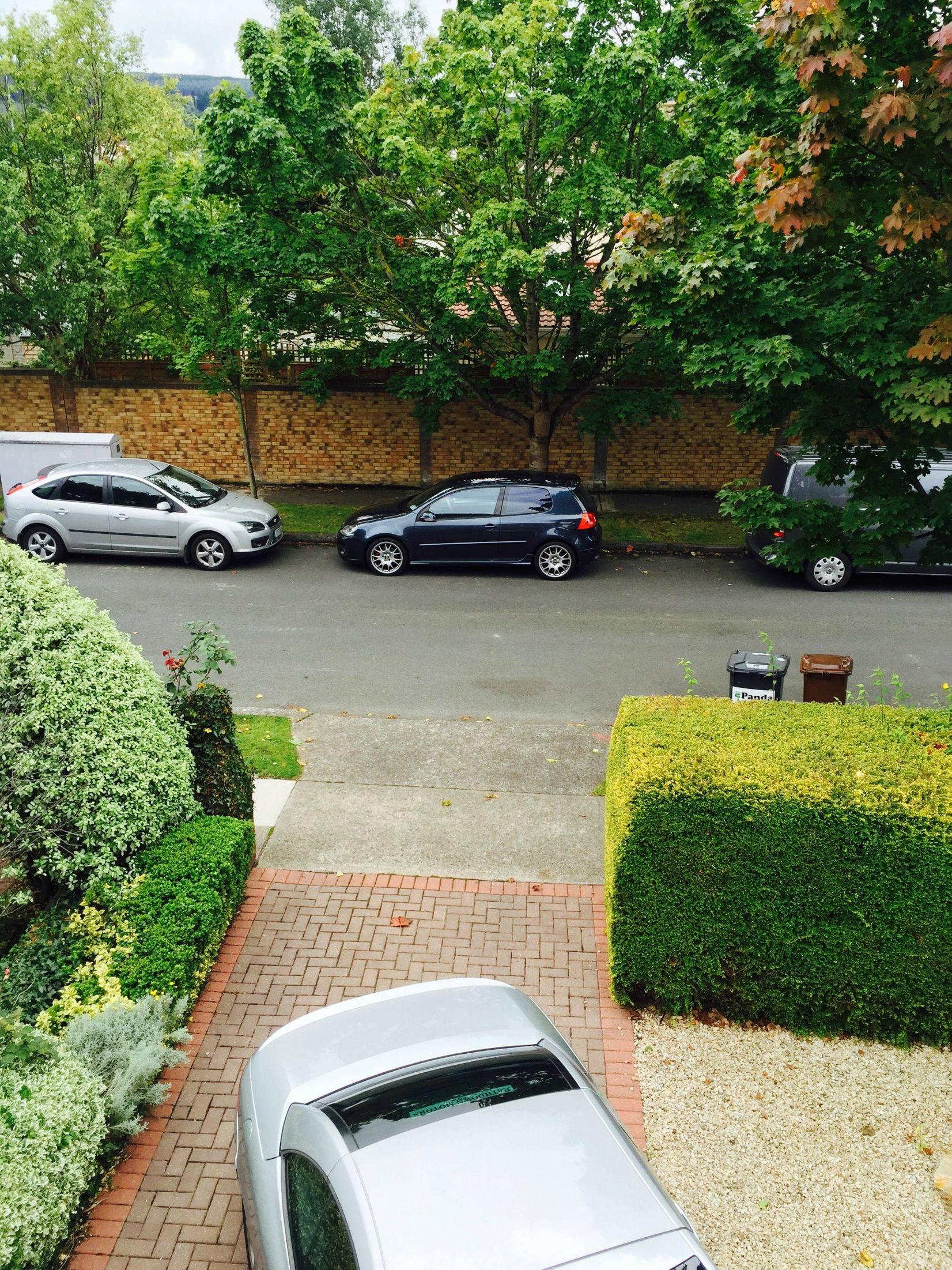

jay2k6ie 0 Posted September 1, 2015 Hi, My car (the blue one in the picture below) has been keyed twice in the last few months and I've had enough so I want to setup a camera system that will be good enough to catch the culprits should they be stupid enough to try it again. The camera will be mounted in a similar position to the picture below and its main focus will be my car across the road. Each incident has happened at night time so it will require good night vision and zoom that will be capable of seeing faces clearly even at night (there are streetlights around so its not completely dark there at night). I have never used CCTV before so I have no idea the type of camera I should buy, DVR etc. Any and all help is greatly appreciated. These vandals have cost me thousands in repairs and now I need to make sure I can catch them should they do it again. Finally I dont have a limitless budget so would love to be able to do this for a few hundred dollars and preferably with an all in one kit (1 camera + DVR) I can find an old 500gb harddrive I'm sure so dont necessarily need a hard drive with the DVR. Thanks in advance Share this post Link to post Share on other sites

jay2k6ie 0 Posted September 2, 2015 The camera is going to be 12 metres from the car and mounted 20 feet up on the front of the house. Share this post Link to post Share on other sites
