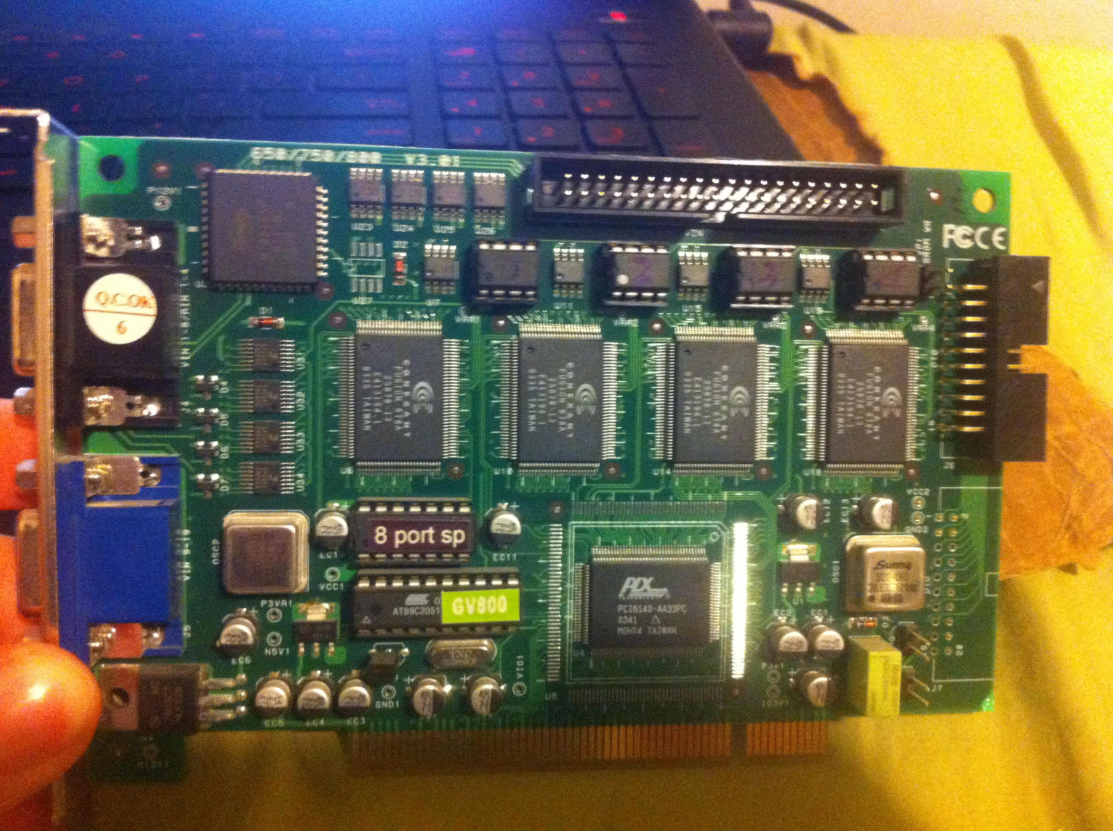

Hey all, I got a geovision GV-800v3 capture card on local classifieds for $20 which seemed like a great deal, it's essentially new old stock, and was never even put in a computer, however the software CD is missing.
All the downloads and links I've found while scouring the web are completely dead, I downloaded the latest one from the site, but it told me it was not compatible (even though it listed this card, I guess they mean the pci express version), and to download v 7.0.5.0 (which has been impossible so far lol)
I doubt it, but maybe someone has a cd they could upload an image of, or knows of how I can get it. I sent an email off to geovision but who knows how long that will take to get a reply on.

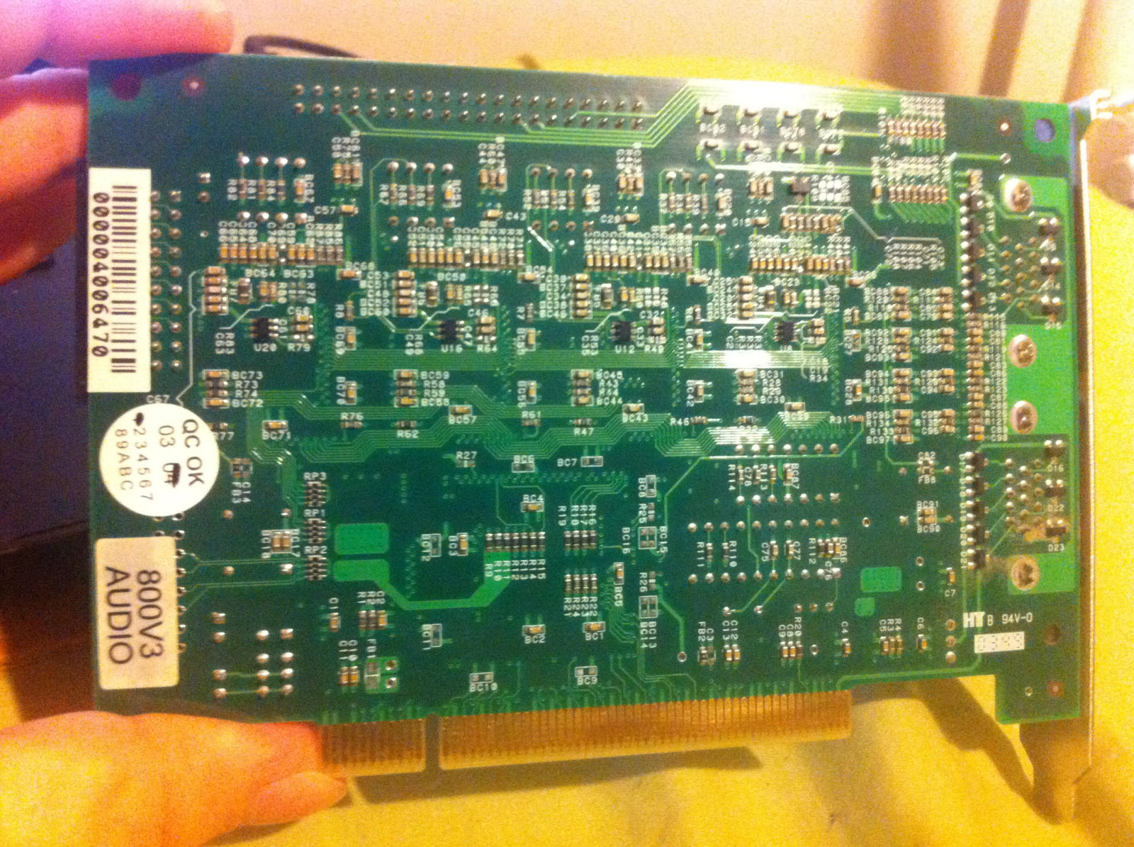

AFAIK, there are many revisions of GV800 card and so the accompanying software version also varies.
For example, GV800v3 card have version 3.0, 3.01, 3.30 and 3.31, also there is a model called GV800_4A card.
So maybe it is best that you can take a clear photo of front and back of that GV800 card and provide it to geovision so you can be sure they will give you the correct answer you are looking for.

I've been looking into it more and found another forum that I missed, however, this mentions that there are a lot of fake card out there apparently, and this has me concerned.
I got it in a real box, with the manual and guide for the audio/video setup, and an audio board (though It's not the correct one, it has a blue pcb and different connectors, since it was from some sort of company I'm guessing they got multiple ones and mixed up parts that they didn't use since it's new old stock, everything had anti static bags, some sealed others were the staple type)
There isn't a holographic sticker on this one and the oscillators are the metal can type, not the other type (small and grey and looks like an inductor).
However this is an old card, so I don't know if maybe that's just how these ones were made? It did ask fo 7.0.5 which they mentioned is another sign of a possible fake, but that was the software telling me it was incompatible, I didn't get a message saying it was a fake. I really hope this isn't, I don't know if it might be or if it's just changes from the years of production. It wasn't expensive, but I can't exactly afford a new one right now lol, plus this is something I need to set up pretty quickly.

Hi,
From the pictures you posted, the card is GV800 ver 3.01 and it looks authentic to me, but it's better for geovision to verify it for you.
