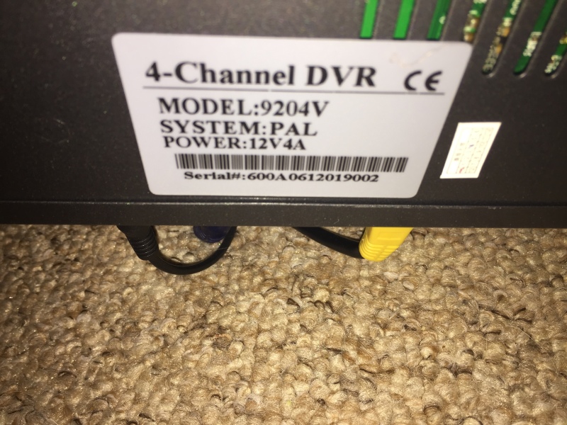

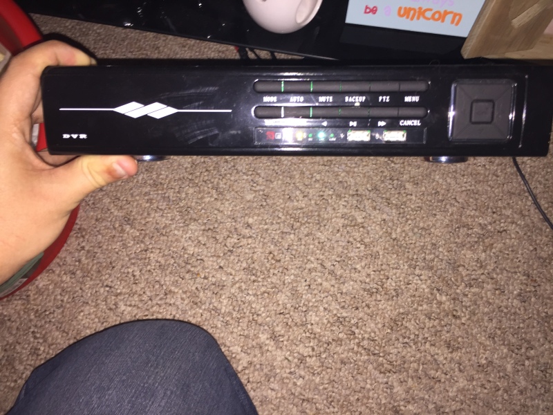

The DVR simply says DVR on the front and then a sticker which says
4-Channel DVR
Model: 9204V
System: PAL
Power: 12v4A
and my serial number.
I know the system software is V2.62.R07 and the build date says 2011-03-21 11:14:52 but other than that I have no idea whats going on!
