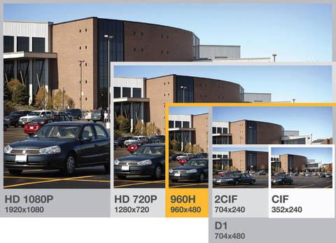

960H is a step down from 720p which is a step down from 1080p. See this image for a rough comparison on image size.
