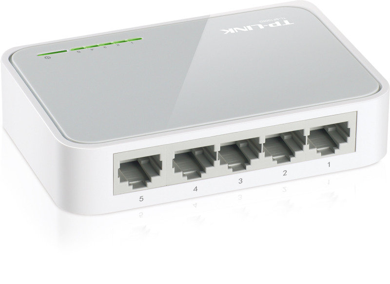

Thanks, I like the idea of using a hardware switch to combine the two security cameras' data over the CAT6 cable from the shed to the house. Yes small price to pay and yes the shed has electric power to support the TP-LINK switch.

You dont need to separate anything out...its a network switch...
It should plug directly into the NVR and work...if not, connect it to your router or any other switch on your network, it will certainly work (you will have to manually enter the IP address of the cameras in your NVR)...
If your cameras are poe, use this for a clean install, http://www.amazon.com/TP-LINK-TL-SF1008P-100Mbps-8-Port-802-3af/dp/B003CFATT2/ref=sr_1_3?s=electronics&ie=UTF8&qid=1446210654&sr=1-3-spons&keywords=poe+switch&psc=1
