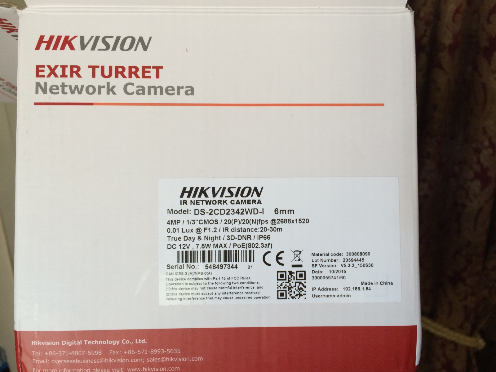

wnix 0 Posted November 20, 2015 I've been looking around for a good chunk of the morning now and I can only conclude that I have the most current firmware? 5.3.3 build 150630. NVR appears up to date as well at 3.3.4 build 150811. Am I missing something? I could find no available firmwares for ds-2cd2342wd-i on hikvision. Is this a 3rd party firmware somewhere? I was also having difficulty figuring out how I would be able to update the firmware as I can only access the camera through the NVR. Would I be able to load the firmware onto a stick and update it at the NVR by selecting the firmware from the stick? Share this post Link to post Share on other sites
Securame 0 Posted November 20, 2015 That BBWR on your serial means you have an international version, so you can flash firmwares without an issue. And yes, you do already have the latest verison for your camera, it is very recent, manufacture date 10/2015, you can see it on the box. Share this post Link to post Share on other sites
tomcctv 189 Posted November 20, 2015 Hi. You have the latest already on cam How are you powering the camera ? Share this post Link to post Share on other sites
