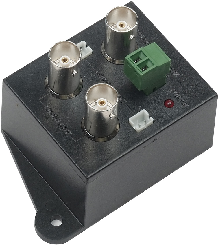

tomcctv 190 Posted November 28, 2015 One in two out ... 4 of these will do your distance with no problems Share this post Link to post Share on other sites

tomcctv 190 Posted November 29, 2015 Bishop said: I just found in my audio/video stuff, a Radio Shack inline amp that was used 15-20 years ago forbeefing up the TV signal for their flying sauser looking rooftop antennas. It has a 9V transformer power supply and has a in and out coax connections. The antenna is still up on the side of our old house, but we use Dish Network now. Would four of these work? Hi. No they will not work .... Don't waste your money on buying others Amp listed above are only a few $ each Share this post Link to post Share on other sites
Bishop 0 Posted November 30, 2015 I've seen several amps online but not your photo item. Where did you find your amp? Thanks Share this post Link to post Share on other sites
