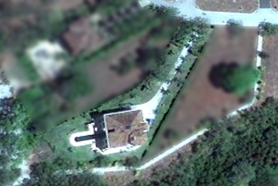

Looking for some guidence on a cctv setup for my friends house on the beach.
Requirements:
Must be accessible via the internet (connection permitting) but also be able to record video locally so that if the internet isn't working it can still record and watched later.
Bonus Options:
A system that can have a master and slave setups. So the security for the community could also monitor selected cameras.
Budget:
5-15K
About the house:
It's 2 stories and the overhang is 1 meter and all the way around the house.
Notes:
Although this is one house there are several neighbors in the area that would like to know what kind of system is worth putting up. Looking to provide 2 or 3 configurations at different price points.
