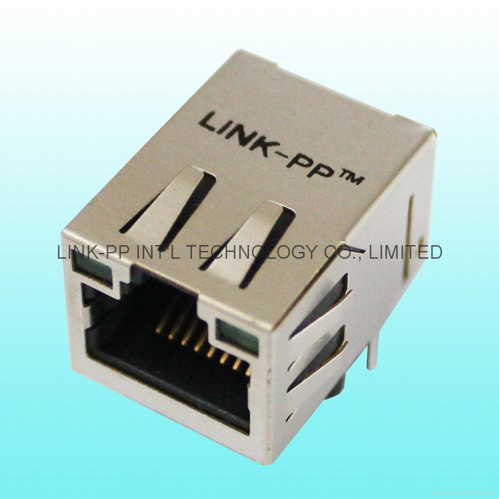

Securame 0 Posted February 10, 2016 sichuan said: My next door neighbor is a retired electrical engineer and he tells me that I shouldn't have a problem with the Cat6a cables being subject to interference as long as the Cat6a cables run perpendicular to any existing electrical wires in my attic and walls and not parallel and next to them but I like the added protection of shielded Cat6a cables and they're not that much more expensive than unshielded cables. You'll have to excuse my ignorance but why will shielded cables be more difficult to install? Last year I ran several hundred feet of shielded Cat6a cables in my basement to three bedrooms and my living room to service broadband TV service, broadband telephone service and Blu-ray players and I didn't experience any problems. Do your TV service, broadband telephone, or blu-ray players use/need shielded network? I think the answer will be no, and in that case, the fact that you use shielded or unshielded cable makes no difference at all. This is a random switch, notice the metal plating on the front, and a shielded RJ45 connector like what you can find on routers, switches, etc: Now here is a typical Hikvision camera, look at the RJ45 connector. Notice that it is all plastic, it doesn't give a damn about your cable being shielded or not, it won't use the shielding. Shielded cables and connectors are more expensive, and the connectors are a bit more difficult to install. The cable is also a bit thicker, but I think that the size difference might be ignored unless you have to pull a ton of cables toguether. It is harder to twist, which makes it harder to go around corners. I have even seen STP installed with normal RJ45 (unshielded) connectors. The person that installed it thought that with that cable everything would be better. Yup, with normal connectors, you bet it will! For the shielding to make effect you have to use shielded cable, shielded connectors, and have equipment that makes use of the shielding on both ends of the network cable, so the shield is grounded. If whatever is connected on both ends of that cable does not have a metal RJ45 connector, the shielding does nothing. In fact some reading even suggests that FTP/STP cable without a proper installation/grounding is actually worse that normal UTP cable. Share this post Link to post Share on other sites
sichuan 0 Posted February 11, 2016 (edited) Thank you very much for the education, Securame. "Do your TV service, broadband telephone, or blu-ray players use/need shielded network?" I checked them all and the answer is "no". "Now here is a typical Hikvision camera, look at the RJ45 connector. Notice that it is all plastic, it doesn't give a damn about your cable being shielded or not, it won't use the shielding." And in all probability any cameras and NVR I purchase will have all plastic connectors. I now understand why you say shielded cables will offer no advantages to me. I am humbled. I just wish my neighbor would have explained this to me or that I could have deduced this fact during all my online research of cameras, NVRs, cables, connectors, etc, etc, etc but then again, I'm just a retired cement mason/plasterer, not an installer or data tech person. I apologize for my ignorance and my stubbornness. I appreciate very much the time and effort you put into assisting me. I say that with all sincerity. I will purchase a 500 ft. spool of standard Cat6a cable. Although I told mattaggie that I didn't trust myself to properly attach the RJ45 connectors both you and he have given me the encouragement I need to do the connections myself. I'm almost certain that I'll make mistakes initially but that's the way we learn. Can you recommend a high quality brand of Cat6a cable, high quality compression connectors, a high quality compression tool, perhaps the ratcheting type and a high quality device to check miswired RJ45 connectors and continuity? Since you are using the Hikvision camera as an educational illustration I would like to ask you something. I always spend considerable time researching items and/or issues before I seek help from others because I don't think it's fair to expect others to do my work for me. Sometimes, as with the shielded cables, I arrive at the wrong conclusions and need to be educated by knowledgeable people such as yourself. After having spent days researching reviews and manufacturers' websites concerning IP cameras I decided to concentrate my further research on three brands of IP cameras, those brands being FLIR, Dahua and Lorex. However, I have also seen a lot of praise for Hikvision IP cameras. I ignored the Hikvision cameras, regardless of the praise and their lower cost, because of all the reviews I read stating that instructions and GUIs were sometimes in Chinese, that customer and technical support for Hikvision was hard to access and that it was often difficult to locate the IP addresses of the cameras. I also read that Hikvision has a huge chuck of the market and that most users of Hikvision IP cameras consider them to be of high quality and high functionality. Could you please let me know what you think of Hikvision IP cameras and give me your recommendation on which brand of cameras I should go with, Hikvision or otherwise? All my cameras will require IR, both inside and outside the house. I would appreciate it very much. As of this time and at this stage of the game I have chosen the FLIR POE NVR located in the link below to go with the FLIR POE cameras I will purchase, if I indeed decide to go with FLIR. I chose this series (the model number being Flir DNR516P6 16Ch Full HD NVR with 16 PoE Ports, 6TB) because of the number of ports, as I don't want to do any new 110 volt wiring in the attic to provide power outlets for any switches, which would enable me to reduce the number of cable runs, because of the self-discovery of the camera addresses and because of the amount of drive space, as I will use the storage continuously instead of motion activated only. It's an expensive NVR but it has a lot of attributes that I'm looking for. Have you ever used or worked with FLIR systems? If so, what do you think of them? I've read that Hikvision makes POE cameras that are ONVIF compliant so if your camera recommendation is Hikvision and there are ONVIF NVRs out there with automatic camera address discovery and good third party software that will work with the Hikvision cameras I'll certainly put Hikvision at the top of my list. I'll put a lot of weight on the recommendations you make. I still have a lot of research to do before I determine what I need concerning camera megapixels/resolution, field of view, varifocal/fixed lens, so on and so forth but those are issues for another time and another thread. Thank you again for your time and any assistance provided. http://www.flir.com/security/display/?id=68369 Edited February 11, 2016 by Guest Share this post Link to post Share on other sites

Securame 0 Posted February 11, 2016 sichuan said: And in all probability any cameras and NVR I purchase will have all plastic connectors. I now understand why you say shielded cables will offer no advantages to me. I am humbled. I just wish my neighbor would have explained this to me or that I could have deduced this fact during all my online research of cameras, NVRs, cables, connectors, etc, etc, etc but then again, I'm just a retired cement mason/plasterer, not an installer or data tech person. I apologize for my ignorance and my stubbornness. I appreciate very much the time and effort you put into assisting me. I say that with all sincerity. I will purchase a 500 ft. spool of standard Cat6a cable. Although I told mattaggie that I didn't trust myself to properly attach the RJ45 connectors both you and he have given me the encouragement I need to do the connections myself. I'm almost certain that I'll make mistakes initially but that's the way we learn. Can you recommend a high quality brand of Cat6a cable, high quality compression connectors, a high quality compression tool, perhaps the ratcheting type and a high quality device to check miswired RJ45 connectors and continuity? Making UTP cables and crimping RJ45 connectors is not that hard, really. I am sure there are tons of youtube videos that can perfectly show you how it is done. I am from Spain, so I really can not point you anywhere to buy good equipment in USA/Canada, but I am sure plenty of people here in the forum will be able to do so. With a good cable (copper, good thickness, etc) you should be fine with normal cable length you can find in a home. I have even tried to use a 300m (that's a full roll, 1000 feet?) pull with POE and IP camera and it has worked. I do not find any problems with POE IP cameras up to 150-200m when using good wire. sichuan said: Since you are using the Hikvision camera as an educational illustration I would like to ask you something. I always spend considerable time researching items and/or issues before I seek help from others because I don't think it's fair to expect others to do my work for me. Sometimes, as with the shielded cables, I arrive at the wrong conclusions and need to be educated by knowledgeable people such as yourself. After having spent days researching reviews and manufacturers' websites concerning IP cameras I decided to concentrate my further research on three brands of IP cameras, those brands being FLIR, Dahua and Lorex. However, I have also seen a lot of praise for Hikvision IP cameras. I ignored the Hikvision cameras, regardless of the praise and their lower cost, because of all the reviews I read stating that instructions and GUIs were sometimes in Chinese, that customer and technical support for Hikvision was hard to access and that it was often difficult to locate the IP addresses of the cameras. I also read that Hikvision has a huge chuck of the market and that most users of Hikvision IP cameras consider them to be of high quality and high functionality. Could you please let me know what you think of Hikvision IP cameras and give me your recommendation on which brand of cameras I should go with, Hikvision or otherwise? All my cameras will require IR, both inside and outside the house. I would appreciate it very much. Can't say anything about FLIR and Lorex, I think those brands only exist in USA/Canada. Surely not in Spain. About Hikvision, I have been using Hikvision products since about 2007, in fact our company used to import Hikvision from China when they were not that big (and their products were not that good). When I joined this forum back in 2009 noone here cared about Hikvision or Dahua, and everyone was talking about brands I knew by name, but most of them I had never used. But with the years both have been growing at a rate of 50% every year, they have become the #1 and #2 CCTV manufacturers, and now everyone loves them. I wouldn't have a problem recommending either one of them to anyone, it is just a matter of taste. I can say things that are better on Hikvision, but I can also say things that are better on Dahua. But they both offer great quality for the price you pay. Share this post Link to post Share on other sites
