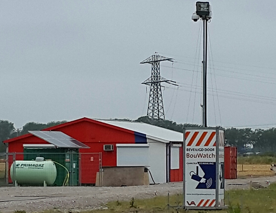

ssmith10pn 0 Posted March 25, 2016 If the contractor has the budget I would recommend this. https://www.earthcam.net/products/trailercamseries.php Share this post Link to post Share on other sites
SeattleBrian 0 Posted March 25, 2016 @ssmith10pn, Thanks for the suggestion. Budget might be a problem. But I think the solution you suggested is for bigger job sites. This GC does residential remodeling. There's barely enough room for his truck(s) and tool trailer. Residential lots in the city in Seattle are often in the 50' x 100' range, and that is consumed by the house, possibly a garage, fenced yard, front lawn, etc. That leaves very little extra room. The big floodlights on that tall boom might not make the neighbors happy. Sorry to sound all negative - I appreciate you offering a suggestion! Share this post Link to post Share on other sites
ssmith10pn 0 Posted March 26, 2016 There are no flood lights. Those are solar panels to charge the batteries. These units are totally self contained. Even has built in 4gLTE Cellular. My state deploys them at rest areas, and just along side of the interstate to observe traffic. The trailer is about 4' x 7' Share this post Link to post Share on other sites
