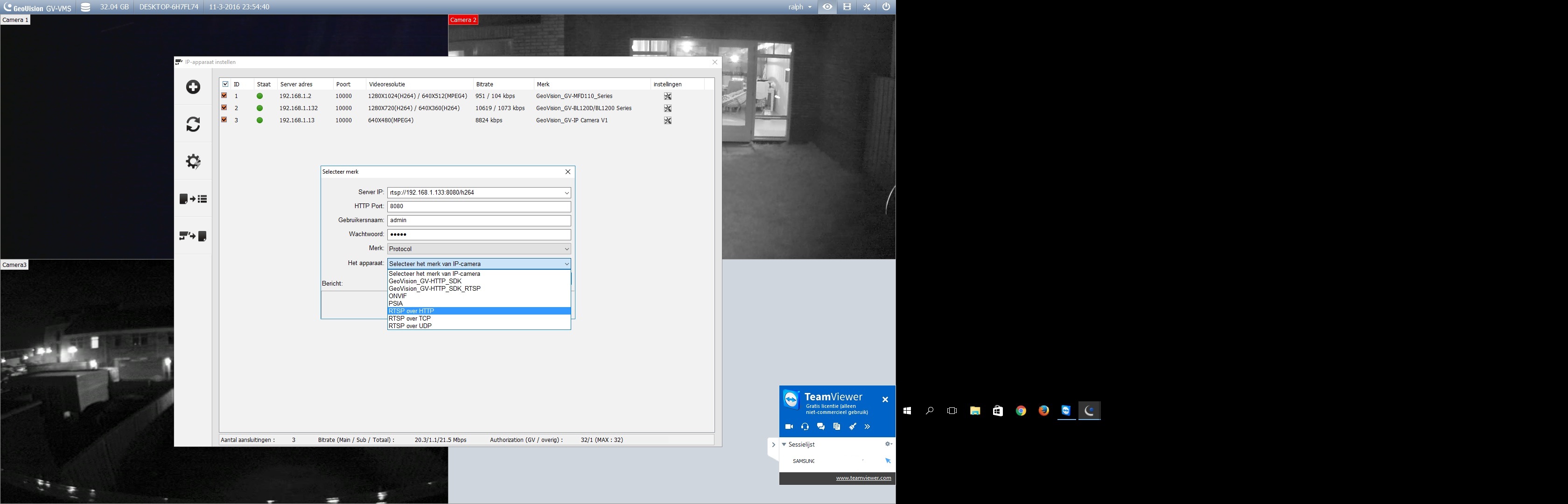

cocacola 0 Posted March 11, 2016 Hello Friends, Seems a new topic will suit better for this. I want to use a Old Android as a extra CCTV camera, only on my local network and i have a dongle license so i can hook up one non Geovision camera. As cctv camera app i am using Ocularlive[/img] and IP Webcam So far no result.. For example this is the Ocularlive app output: Camera Ip address is 192.168.1.133 rtsp://192.168.1.133:8080/h264 rtsp://192.168.1.133:8080/jpg http://192.168.1.133:8080 http://192.168.1.133:8080/live.mjpeg http://192.168.1.133:8080/live.jpg http://192.168.1.133:8080/onvif/device_service Which of the below options do i choice ? Has anyone a idea how to set it up? I am quite sure it`s possible, just need to figure it out. The possibility of a wireless android camera are huge! they are really tin so i can set them up easy! Share this post Link to post Share on other sites
cocacola 0 Posted March 12, 2016 Got it to work! Server ip: your local camera ip, in my case: 192.168.1.133 user and pasword. In the tap RTSP setting: rtsp://192.168.1.133:8080/h264 (do not forget the rtsp://) Note: In my case i need to restart GV VMS for each new camera modification, my brothers system has that to if you want to have acces to all settings from the camera`s. If you got a dongle for Geovision VMS this should work. For now the phone/camera is running stable for a small two hours, and give good video feed (and this is in 800/600 resolution, 30 frames) 0 Share this post Link to post Share on other sites

cocacola 0 Posted November 9, 2016 RichTJ99 said: I am trying to get this one working: https://play.google.com/store/apps/details?id=com.pas.webcam&hl=en I didnt like that Ocular put the data right online. It also crashed on me often. Anyone play with the IP Camera software with Geovision? Thanks, Rich All those programs can produce a stream, Ocular stream has been easyer to figure out. I remember other Android programs had more difficult streams. For example HD stream from a other cctv phone program i put in the Geovision: rtsp://192.168.1.101/user=admin_password=ABCDEFG_channel=1_stream=0.sdp SD Strem or secudair stream: rtsp://192.168.1.101/user=admin_password=ABCDEFG_channel=1_stream=1.sdp Crashes of the phone can be due to heat, so try out some phones that work the best. Also remove all other non essential apps from the phone, like virus/adware scanners specially. The cool part is you can add a 8 megapixel camera for only a handfull of dollars to your system. My Galaxy two for example gives in daylight the best overall image i ever seen. Its so clear and even digital zoom can create good picture. I did not try out more them 8 megapixel. You can now also add a cheap camera like this to the system. If you need any help whit unfolding the correct stream send me a message. Share this post Link to post Share on other sites
