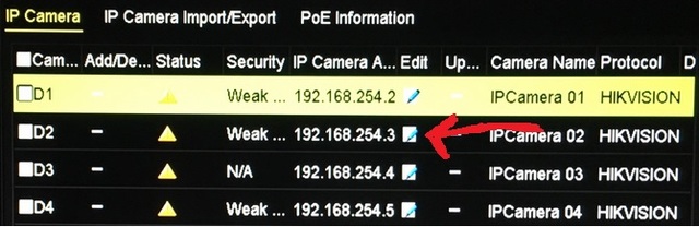

Jibbeh 0 Posted April 1, 2016 You have a 16 way NVR with 16 ports of POE on the rear, as default is assumes the 16 cameras will all use those POE ports so you need to 'edit' a port and change it from 'Automatic' to 'manual' and enter the details for the appropriate IP camera you have in Building B. Thats the edit button but I cant find a pic oif the settings in there. But thats the place you need to be looking. Share this post Link to post Share on other sites
videoVIP 0 Posted April 1, 2016 Yep, just figured that out. Will fill you in on the details later. Thanks, all. Share this post Link to post Share on other sites
