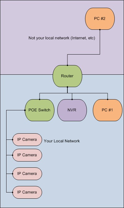

I'm not fully understanding your text-based layout. Are you referring to something such as this?
For PC #1 (one that is on your local network)
It'll connect to the NVR easy-peasy just using the local IP address of the NVR (such as 192.168.1.108..or whatever it has been assigned on the local network).
for PC #2 (outside the local network)
It can connect if there's a mechanism for it to pass through the router, such as a port-forward setting on the router.
Everything connected to the POE switch, if you do have enough ports (NVR, router and PC do not need to be on a POE port).
PC and NVR could actually be coonected to the POE switch or router, but the NVR would make a lit more sense connected to the switch, so the network traffic from all the cameras does not have to go through both switch and router.
