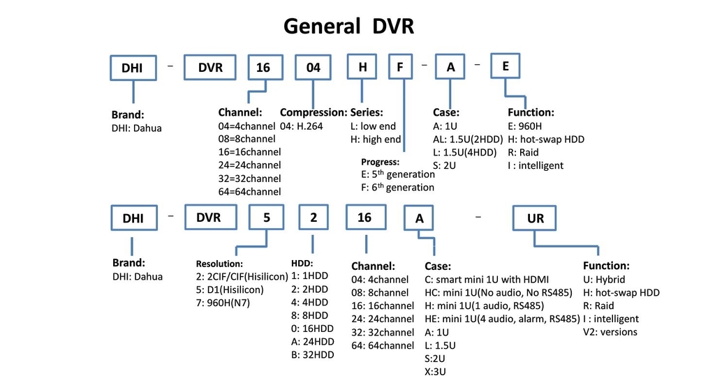

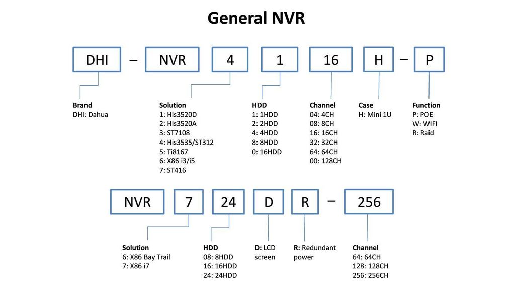

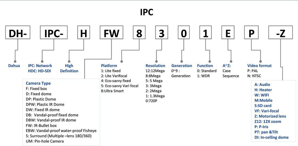

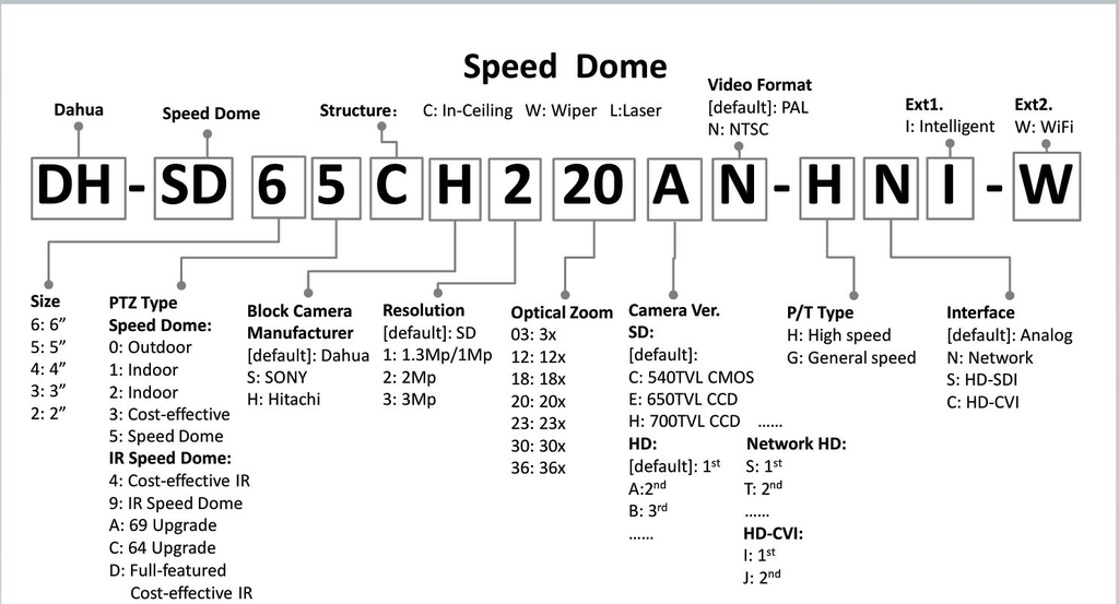

So far, I work with Hikvision products and want to explore Dahua IP cameras.
After much searching in wwww.google.com I not found code name rules in Dahua IPC cameras. Series cameras, resolution, what they mean every number in the name and letters / PAL, NTSTS, audio, wifi, tf card slot and etc.../.
How to differ Chinese model from the rest. Does multilanguage version as with Hikvision cameras.
Can anybody help?
