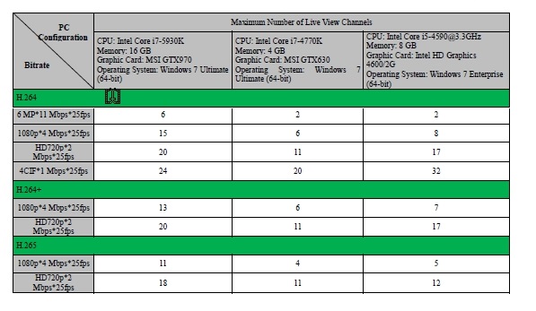

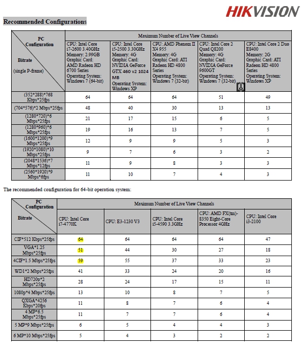

Thanks to CHINA Hikvision Support Team! This is the GPU and bandwidht iVMS-4200 specs...
We were lucky! Our integrated GPU is on the list, and 32 max CIF recommended live views matches our tests... beyond there, system becomes not responsive.
Note that 3 GPU options are described in last chart;
HD 4600 - Passmark: 704, onboard, shared RAM
GTX 630 - Passmark: 790, 2gb, 50W
GTX 970 - Passmark: 8700! (almost 10x more powerful), 4gb, 150W (too big and hot for our target PC)
Weird, I hope more performance from such a beast. GTX 630 is on pair of HD 4600.
