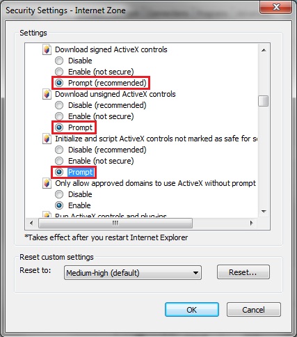

Also I have not found a solution for some older DVR machines to play web based streams/video playback in browser, I can login usually and set settings but when viewing live it won't load a activex error etc occurs, so the solution for me was to run Internet Explorer in Compatibility View and as administrator then the DVR pushes a download if the settings are set properly (insecurely)
