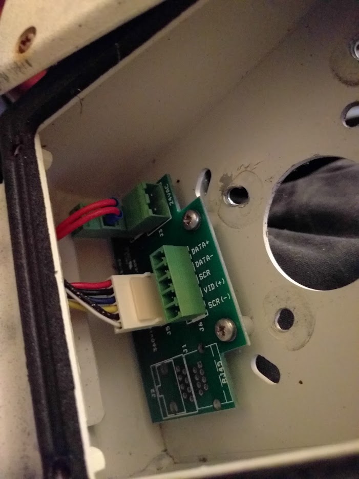

Hi can anyone help me with what wires should go where?
289476_1.jpgp
I've hooked up 24v but still got these connections above to hook up but not sure where to start?
DATA+
DATA-
SCR
VID(+)
SCR (-)

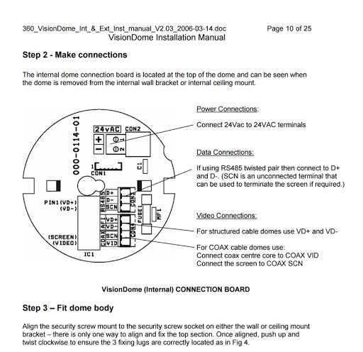

Is a document I found online but again still not understanding it unfortunately.

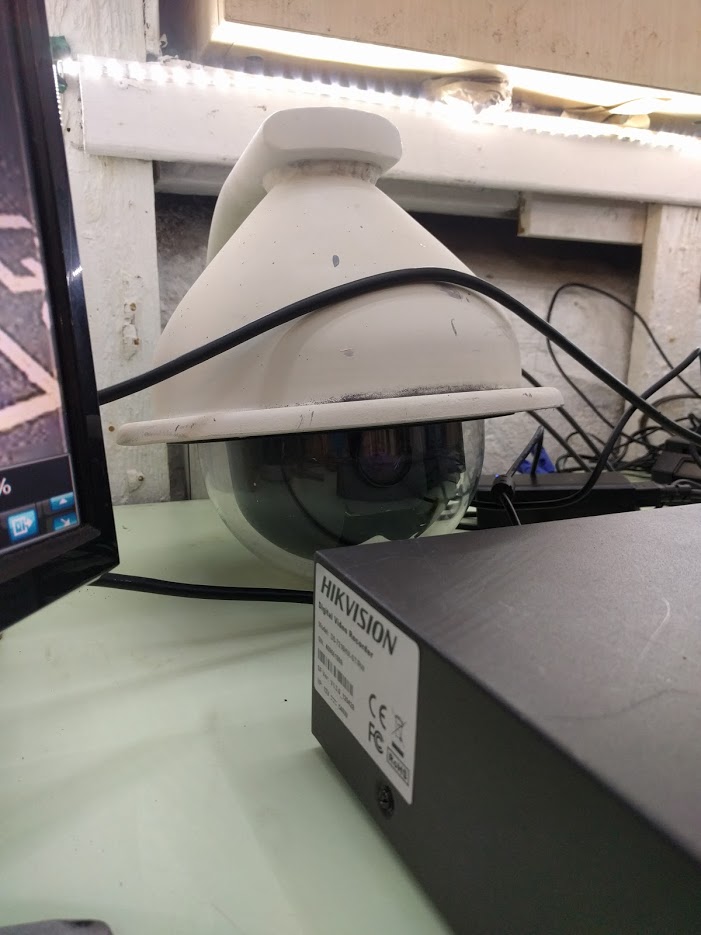

Image of the unit itself.

Cheers Daryl but no game, so put vid + to the centre wire of the bnc cable
And I put scr to the outer mesh wire of bnc cable nothing so tried wiring scr to scr - to terminate it or something I read? and that didn't bring it up either
Not sure what else to try but any suggestions from anyone welcome!
Hi. Have you set up the address and rate on your dvr.
Some domes will display the camera settings when you power down and back on again
I know this dome as the vcl orbit. You have not supplied a pic of the tell entry board I need to see the settings
