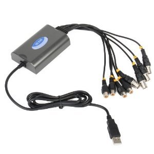

Mr. Anonymous 0 Posted August 29, 2016 I picked up a cheap 4 channel USB DVR capture device, and it came with some DVRS software that is not that great. This unit only supports D1 not HD however identification is not an issue right now it just monitors traffic. I do not even think the software has any Apple store compatible viewing apps. I know BlueIris is suppose to be a leading universal DVR software but what else is really good? Preferably something that has a motion sensing map, I see some software supports a grid-like motion sensing system. Along with remote viewing from iPhone? Suggestions please Share this post Link to post Share on other sites

Mr. Anonymous 0 Posted August 30, 2016 Could you please post the picture of your DVR - 4Ch USB? Sure, avoid this product though. I think the new revision has vent holes now. I wish I could find an HD version of this unit! Share this post Link to post Share on other sites

SunnyKim 2 Posted September 1, 2016 Could you please post the picture of your DVR - 4Ch USB? Sure, avoid this product though. I think the new revision has vent holes now. I wish I could find an HD version of this unit! Please allow me to explain why the USB DVR can not support HD size video or kinds. The interface is UBS2.0 which allows Max 480 Mega Bit Per Second. In terms of Byte, 60 MBPS. But considering communication over heads and bufferings for smooth processing by CPU on PC or Laptop, it allows Max 23 MBPS, narrowly passing D1 Sized Video Data of 30 Frames Per Second. For 4 Ch, the video previewed and recorded is to be limited to CIF sized (352X 240, NTSC) for each channel. Share this post Link to post Share on other sites
Mr. Anonymous 0 Posted September 1, 2016 Could you please post the picture of your DVR - 4Ch USB? Sure, avoid this product though. I think the new revision has vent holes now. I wish I could find an HD version of this unit! Please allow me to explain why the USB DVR can not support HD size video or kinds. The interface is UBS2.0 which allows Max 480 Mega Bit Per Second. In terms of Byte, 60 MBPS. But considering communication over heads and bufferings for smooth processing by CPU on PC or Laptop, it allows Max 23 MBPS, narrowly passing D1 Sized Video Data of 30 Frames Per Second. For 4 Ch, the video previewed and recorded is to be limited to CIF sized (352X 240, NTSC) for each channel. This makes a great deal of sense with the bandwidth limitations, I would need four single channel HD DVRs on separate USBs to even come close to what I wanted. I am now looking at DVRs on eBay that will record 1080 @ 15fps which is better for identification than 720 @ 30fps in my opinion. I can buy a 4 channel DVR (without drive) for $150 that also supports two network cameras. I am confused how I would be linking the new DVR to my PC though, I do not want to run the HDMI to my monitor I actually want it on my desktop. I am assuming this is done via USB or Ethernet? In a sense the analog channels would be converted and sent over the Ethernet? Of course there is no need to use remote desktop connection anymore with a DVR I can just load some sort of remote/viewing software on all my PCs? Share this post Link to post Share on other sites
