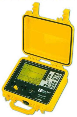

It's crazy what they build into these things now. I noticed two models have fiber testers and a Time Domain Reflectometer all for $600. I LOVE having a TDR available, but heck my Riser Bond TDR probably weighs 15# by itself and was $3500 back when I bought it.
You can get TDR for less than $400
check ByteBrothers
Yep. A lot has changed since I bought my old Riser Bond 1270 decades ago.
They're still expensive, but back when I bought mine for TSCM work there were no inexpensive alternatives. Thanks for the lead on Byte Brothers. I'll take a closer look at what they have to offer. I own a HVAC company too, and it looks like they might have a solution my techs over there have been searching for.
