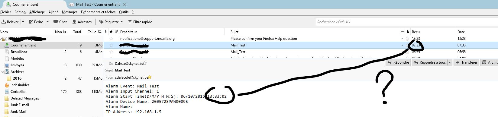

fa355115 1 Posted October 6, 2016 Hi there, I have configured SMTP mail notification on my Dahua IPC-EBW81200 and the mails are sent straight after the alarm trigger (or "test mail") but mails are appearing with a reception date / hour which is 6 hours before the effective mail sending ... Do you experience the same issue with your Dahua Cameras ? I have changed the timezone from GMT+2 to GMT+10 (for example), but the mails are always with a 6 hours différence .... Any idea what that could be ? A bug ? Many thanks for your support ! Share this post Link to post Share on other sites

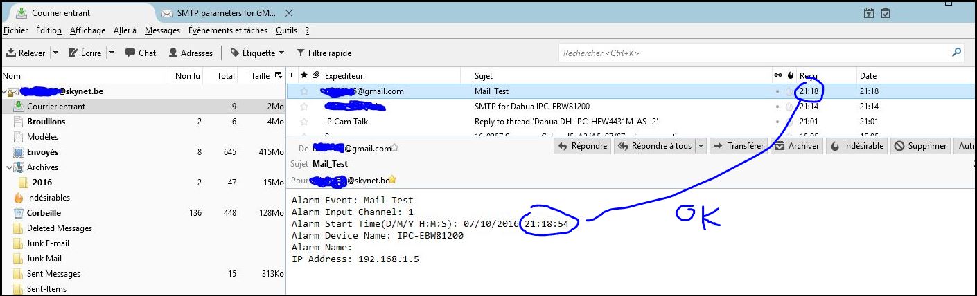

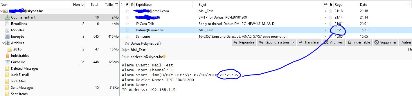

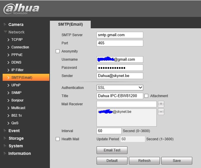

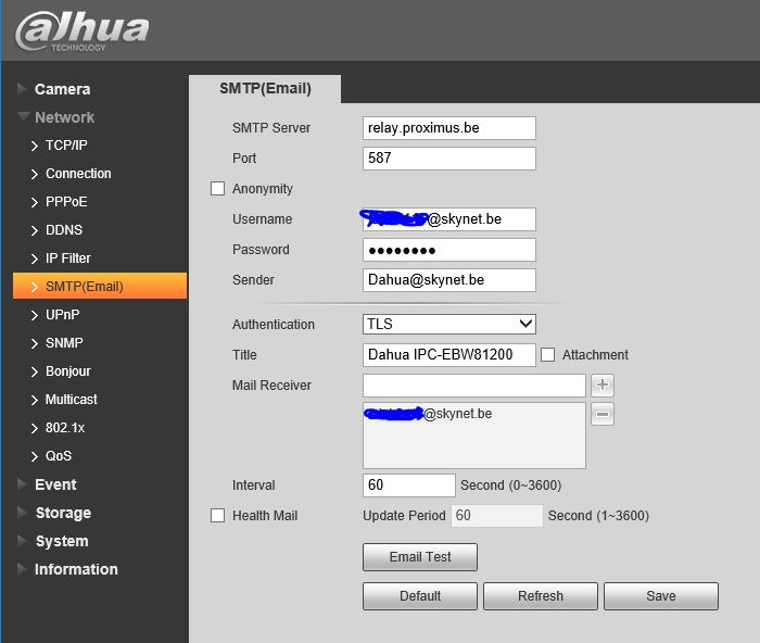

fa355115 1 Posted October 7, 2016 I do not understand anymore ... I just tried sending mails from the GMAIL smtp as well ...and there no issues ... reception hour is correct Passing through proximus SMTP, reception hour is incorrect : SMTP GMAIL on the camera : mail received with correct timestamp : SMTP proximus on the camera : ... mail received with incorrect timestamp : I do not understand ...why passing through proximus as sender the reception hour is incorect ??? Share this post Link to post Share on other sites
