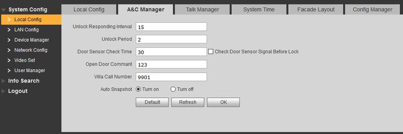

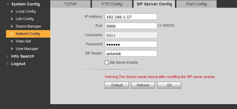

EDIT:
Here screenshots of settings in VTO:
That's all

username=VTO2000A   ;it is important that in VTO as RELAM are set asterisk!

If someone rings the bell of VTO, I want ringing the VTH1550CH, ringing my FritzFon (over Fritzbox) and when I'm not at home, my Android-Smartphone should ringing to. And everything with Video. Well ringing with Videostream over Fritzbox will not work because the Fritzbox doesn't support SIP Video. But there is a possibility to use Snapshots instead.
Regarding that part i have a solution now that should work, but i don't see a picture on my Fritz!Fon iOS APP nor a request by Fritz!Box in my apache'2 logfiles.
What i did is add the snapshot solution which i already posted to the dialplan, liks so:
exten=>9901,1,Ringing()
exten=>9901,n,Answer()
exten=>9901,n,TrySystem(avconv -i 'rtsp://admin:xxxxx@192.168.xx.xx' -f image2 -vframes 1 -pix_fmt yuvj420p /tmp/snapshot.jpg)
exten=>9901,n,TrySystem(chmod 666 /tmp/snapshot.jpg)
exten=>9901,n,Dial(SIP/11@fritzbox&SIP/linphone,30,r)
exten=>9901,n,Hangup()
That rings my linphone iOS app and my Fritz!box. The Fritz!Box for now only rings my iOS Fritz!Fon app.
Then i added the following to my apache'2 default site config:
Alias /snapshot.jpg /tmp/snapshot.jpg
<Directory /tmp/snapshot.jpg>
   Require all granted
</Directory>
After i ring the doorbell i can point my browser to my apache2 (same machine as my asterisk) using the URL http://192.168.xx.xx/snapshot.jpg and i can see the snapshot.
On my Fritz!Box i then entered that .jpg link into the "Live-Bild" fields but looking on my apache's logfiles i can't see any request from my Fritz!Box to my webserver when i ring the doorbell.
With this solution the snapshot is there, but as i don't have hardware fritz!fon's i can't help any further. But maybe this helps you on your way.
I for my part will now try to send a telegram or whatsapp message with the snapshot whenever someone rings the bell.
edit1: Removed dialgroups and add SIP targets with &
