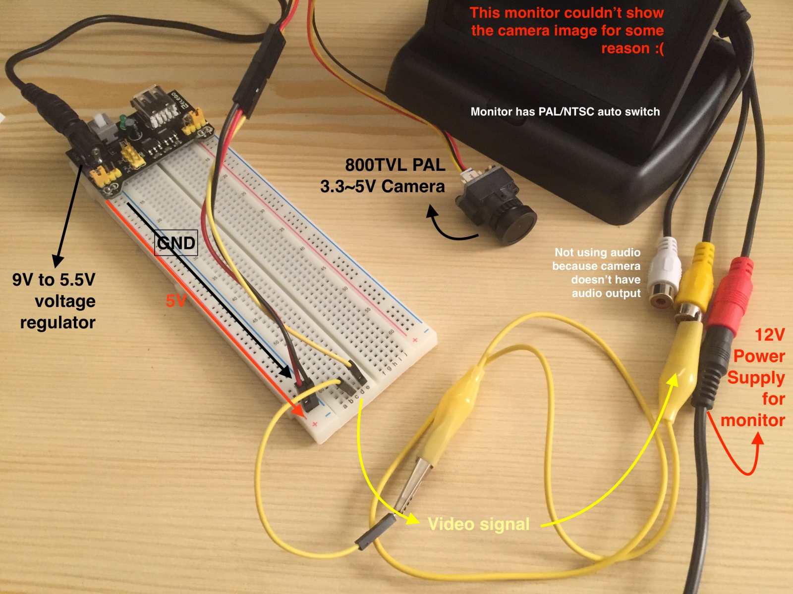

This question seems simple, but I just couldn't get the monitor to display the image from camera.
Basically, I'm trying to connect the camera with the 4.3" monitor I got the other day. The monitor should have displayed the image captured from the camera right away after I plug in the power, but for some reason it just couldn't display anything.
I'm wondering if there is anything wrong with my setup. I mean, I followed everything on the camera's manual and I'm pretty sure that I got the power, ground and signal connected correctly. But, it just doesn't work the way I want it to be.
Here the link to the similar setup on youtube:
It actually works. How come mine doesn't? Can anyone please point me where I did wrong?
This is your problem .... Your yellow to monitor should only go to centre pin of rca yellow plug ..... You then need a ground either from camera (black) or from your brake out box (ground) to the outer of your yellow rca
