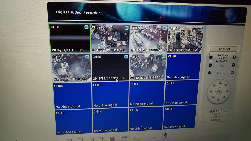

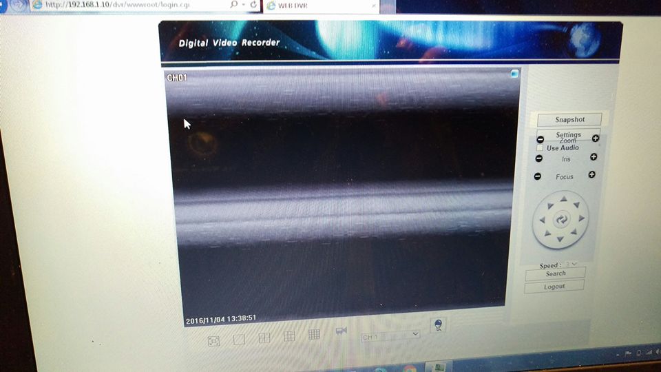

I am having camera problems. I have tested the camera stand alone with a power supply but when i hook it up to this system with a new power supply I get no picture. 294569_1.jpg294569_2.jpg
Standard check procedure:
- check the camera with short signal cable and tested supply (as I can see, you've already done that)
- check the signal cable (continuity test). If you use UTP and video baluns, check balun polarity.
- check power supply voltage on camera side under load condition (with camera connected)
- connect camera to some other channel and connect other camera to ch 1 to see if there is something wrong with ch 1.
