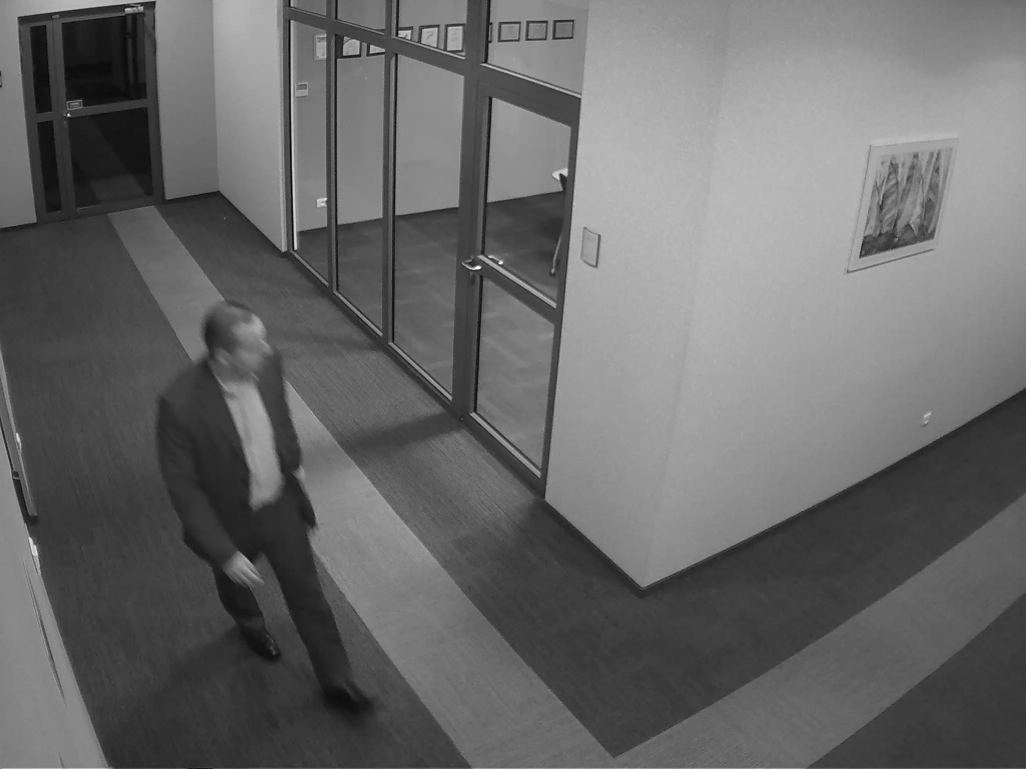

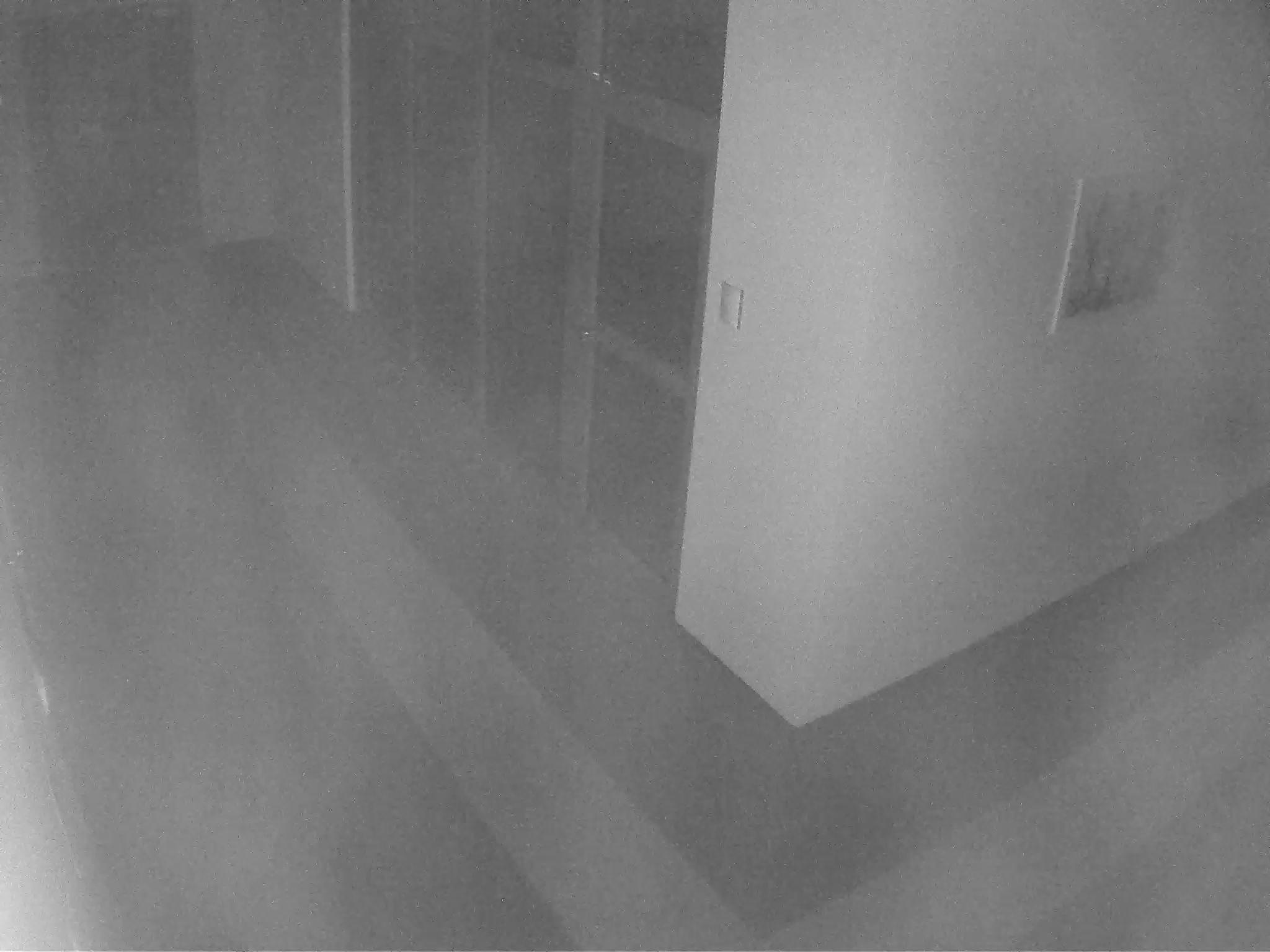

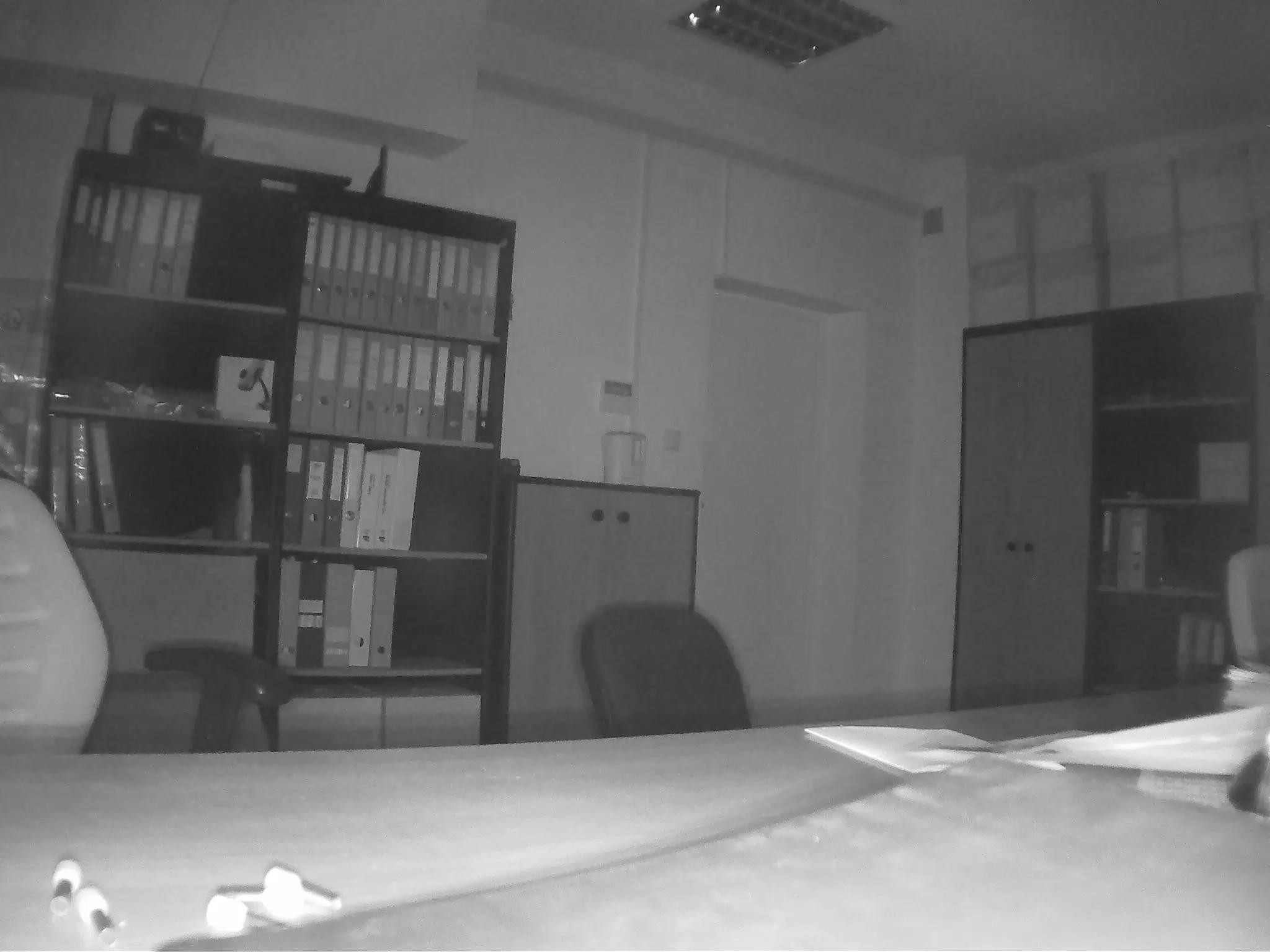

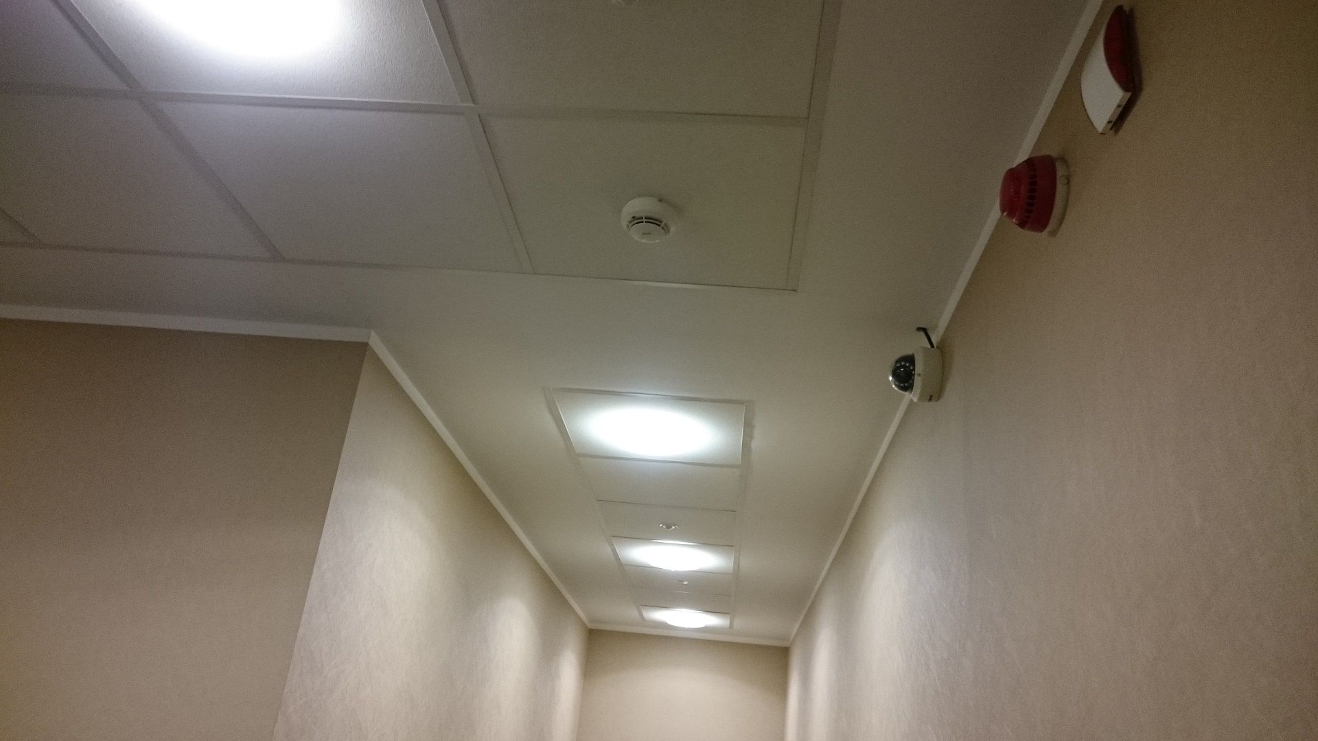

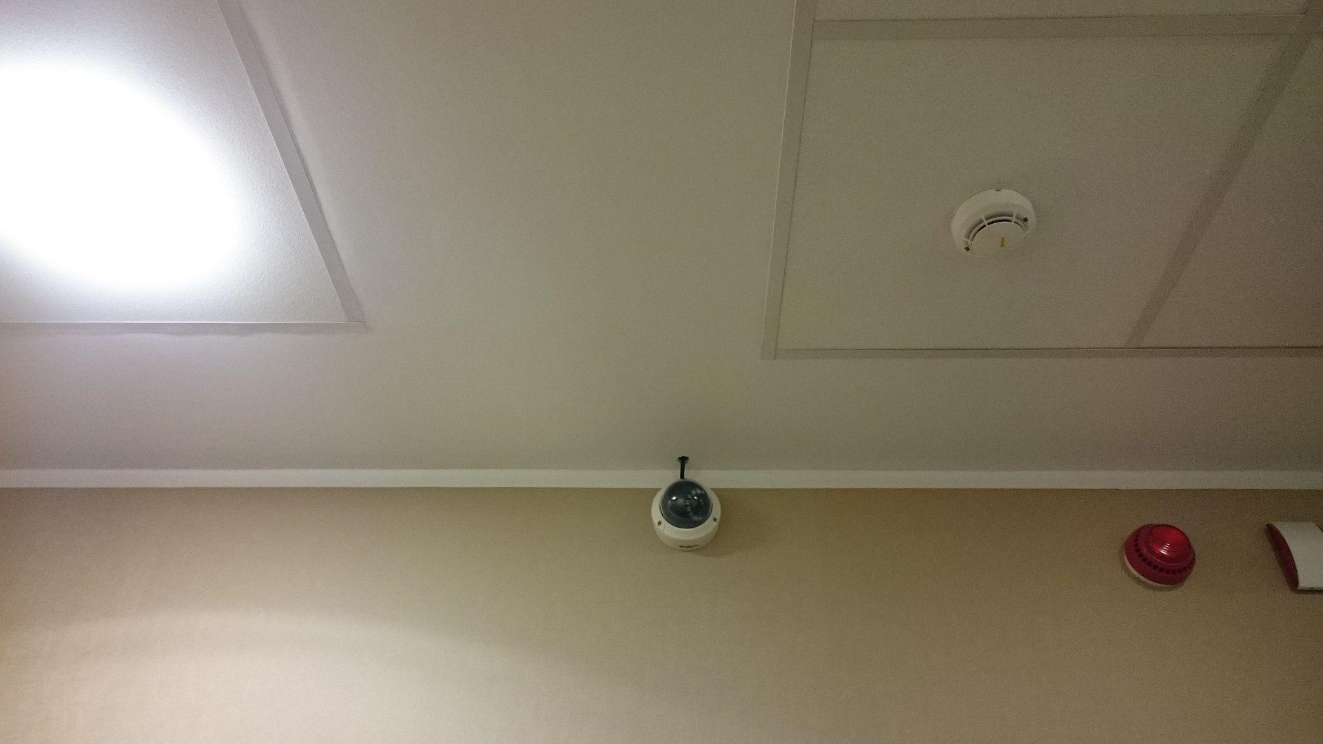

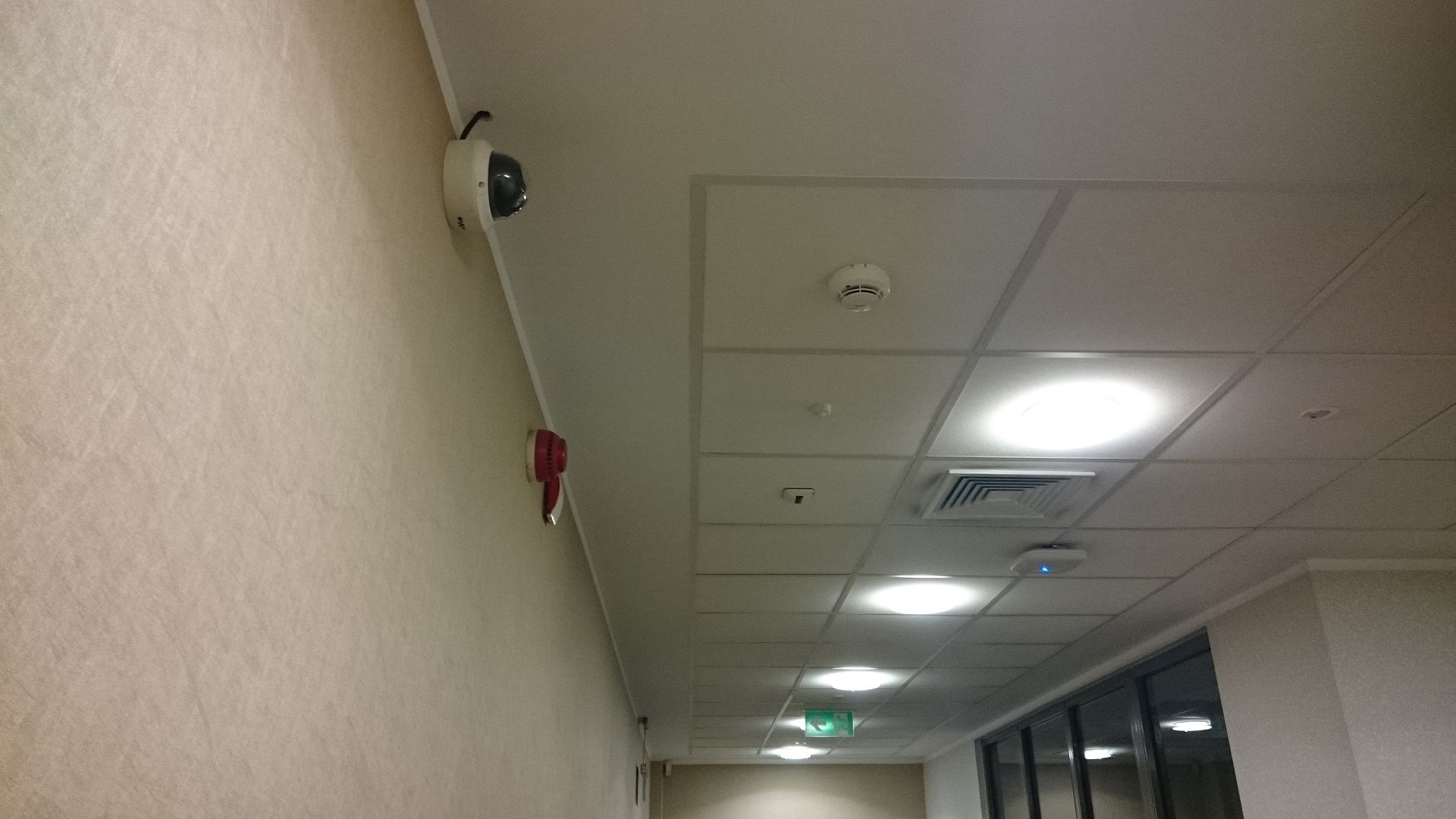

adasiuu 0 Posted November 29, 2016 Hi, Image from indoor dome camera (NVIP-3DN5040V/IR-1P) is very foggy in night mode: Lens and cover (also from inside) is clean. Cover has some scratches. IR LEDs works well. Lens have rubber seal wich is in well condition and pressed to cover so IR can't reflect from inside. I thought the camera sensor has been damaged but when we tested it in office we get this image: Any ideas whats causing this fog? Mounting looks likes this: In night mode and lights on image from camera looks likes this: I don't have sample from day mode but it looks the same as above (sharp and clean) but in color. Share this post Link to post Share on other sites

the toss 0 Posted December 2, 2016 Your problem is the mounting position of the camera. You are getting IR reflected off the ceiling tiles. That camera is designed to be mounted horizontally. I know in many cases it can be used in the vertical plane but (as you have seen) there can be problems. Either remount it to the ceiling ( and fix the wall) or get an L shaped wall bracket to use. The same problem is often experienced by novice installers who mount a similar camera under an eve. They invariably mount it as far back towards the wall as they can to keep it out of the weather and end up with the same reflection problem from the eve. Share this post Link to post Share on other sites
