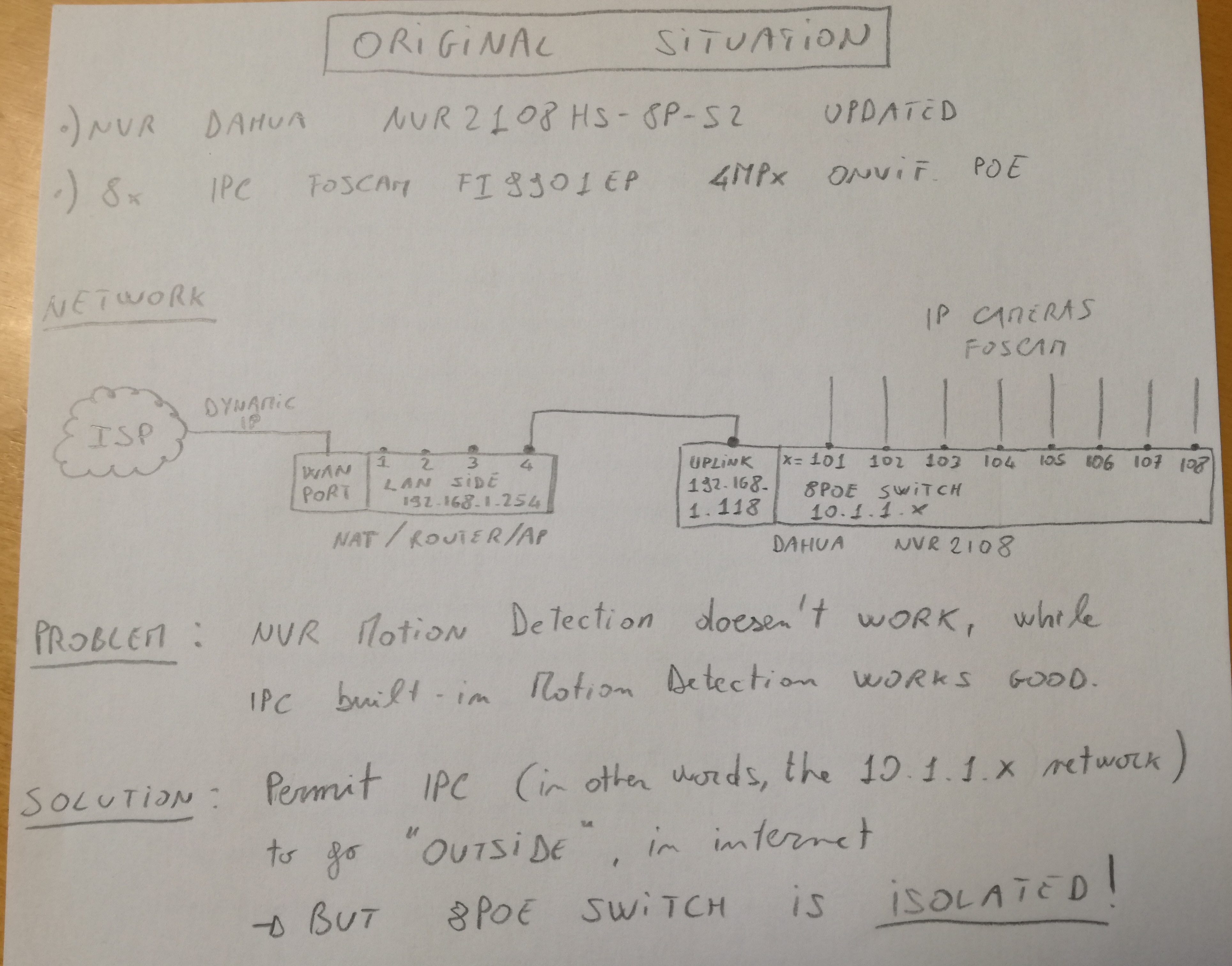

Hi all and thank you in advice for your help.
I have a DAHUA NVR 2108HS-8P-S2 with built-in POE switch, and 8 Foscam IPCAMERA Onvif FI9901EP.
Because of is not possible to have motion detection directly on NVR, I want that my IP Cameras go on internet, so I wanto to remove the isolation of built-in switch.
I attach 2 images that explain the situation.
Is possible to add a route or a gateway that tells to switch-connected devices "if you wanto to go outside (another network), your gateway is the uplink port of NVR", just like a normal Router/Access point with LAN ports and WAN port?
Thank you so much.
ORIGINAL SITUATION

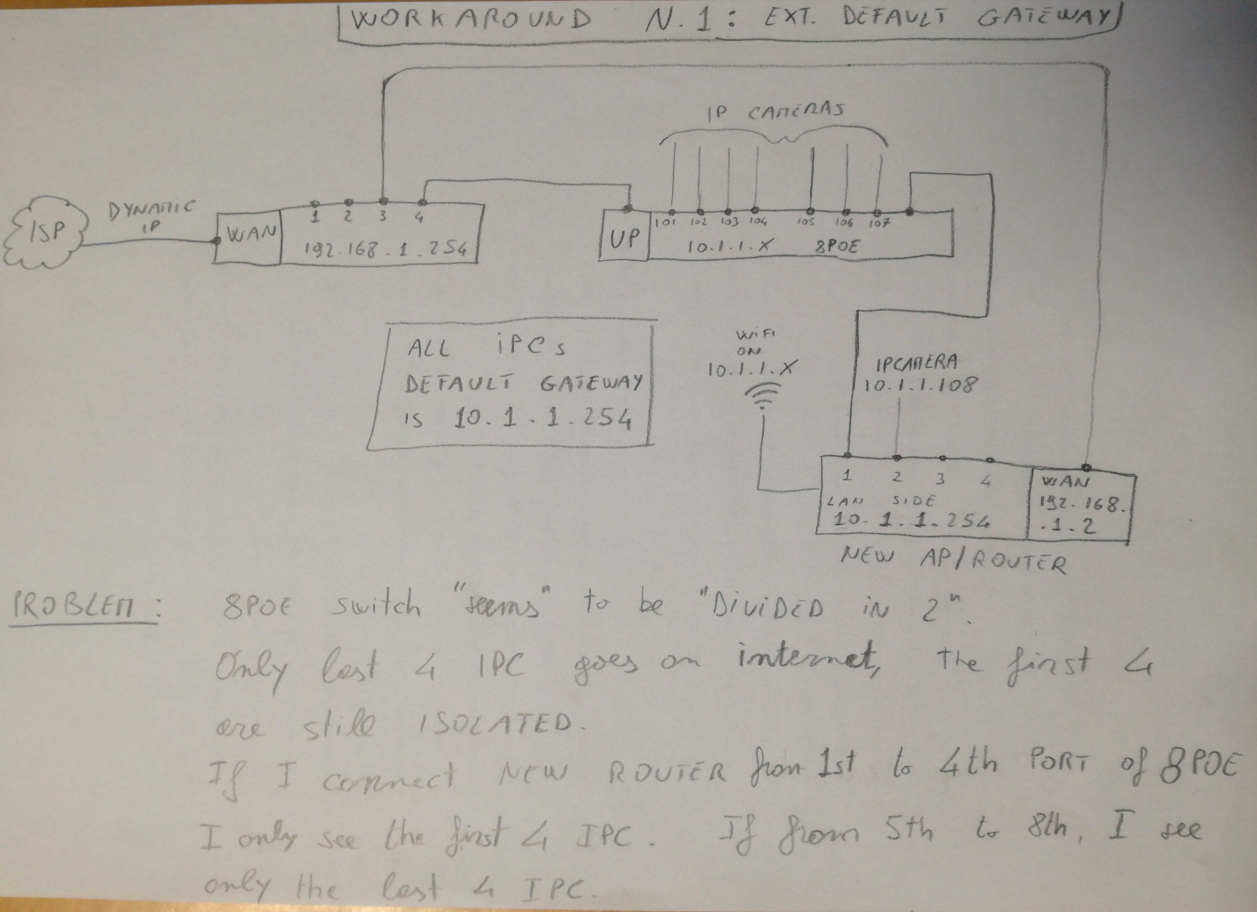

WORKAROUND
