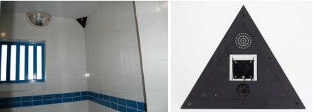

What type of setup they use in jails to prevent tempering?
Dome camera. Typically the camera will use a special fastener that requires a special tool to unscrew it. However, if you have all these people dead set on destroying your stuff, there may not be much you can do. If its within reach, its not hard to take a bat, crow bar, spray paint, etc to the camera.
