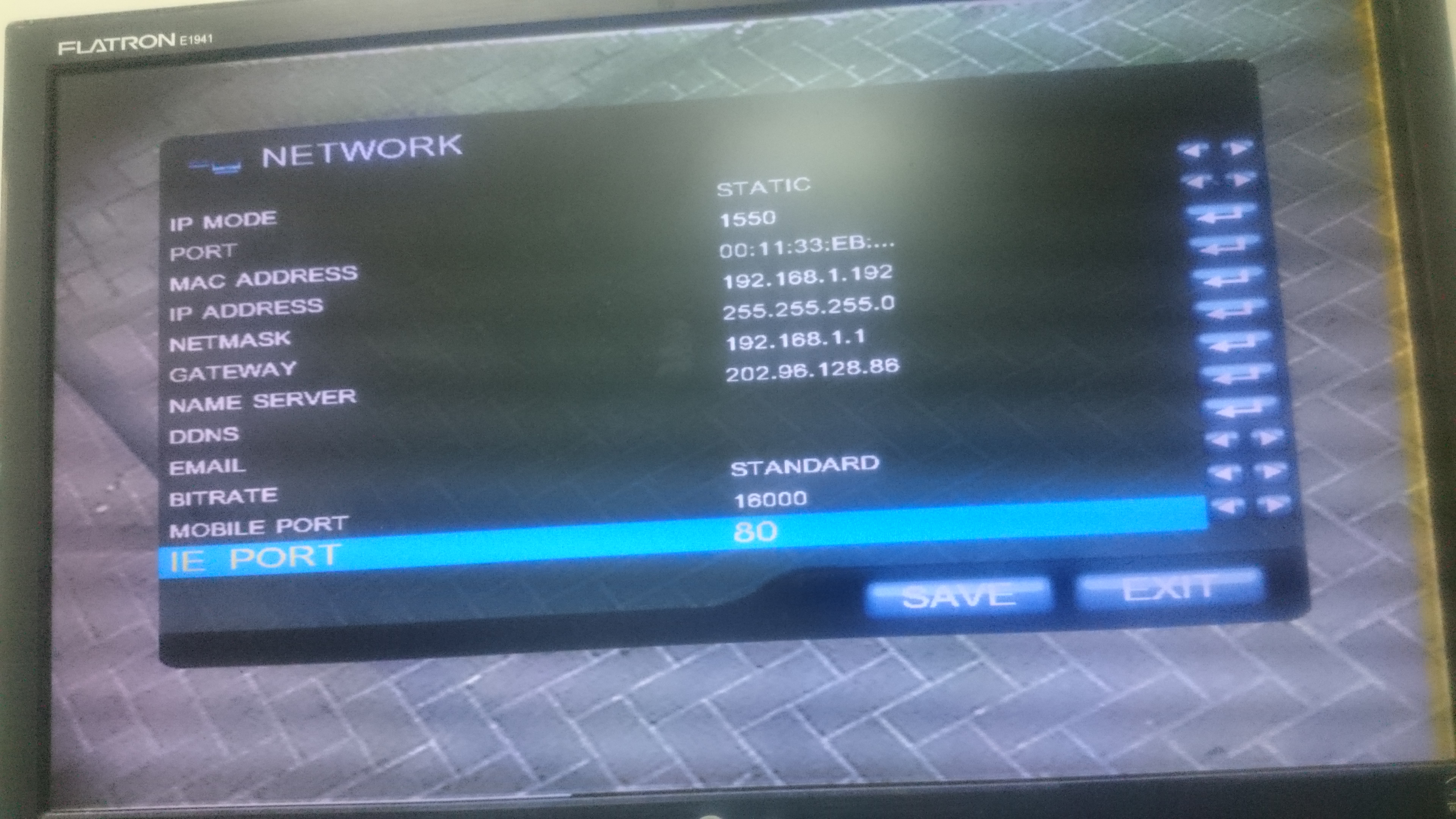

Uvuvwevwevwe Ossas 0 Posted February 16, 2017 I want help in establishing a remote connection with my DVR and my other network ( my home ) I tried port forwarding all the ports 16000,1550 and 80 This is the network config of my router It's working with the same network when I type the IP, it works but it doesn't work when I try with other network ( IP:80) DDNS option doesn't provide anything so that's a no go. So is there anything am doing wrong ? Any suggestions ? Share this post Link to post Share on other sites

Netcelero 0 Posted June 30, 2017 Only the private IP address that you see in the screenshot will work within your network, unless you have a really good router with NAT reflection set up the public IP address ( the 202.96.128.88 ) won’t work from within your network only from outside. Share this post Link to post Share on other sites
