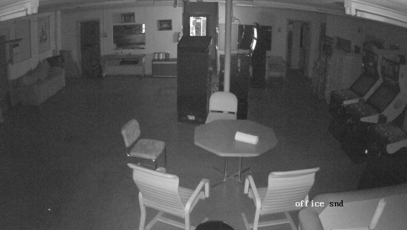

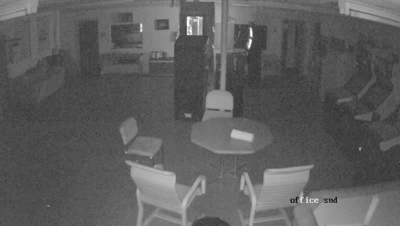

2 weeks since WDR reset last on a DS-2CD2542FWD-IS, mounted directly to a wall, POE from a cisco SF200-24FP-NA switch, 60ft of cat6
same camera 1 hour after resetting WDR

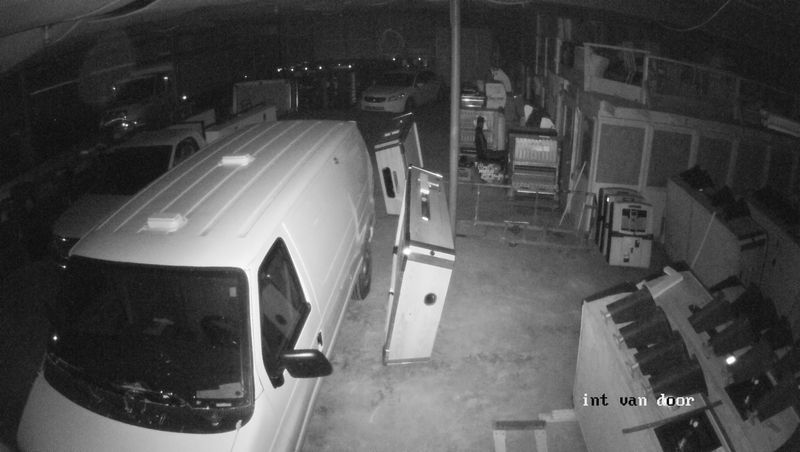

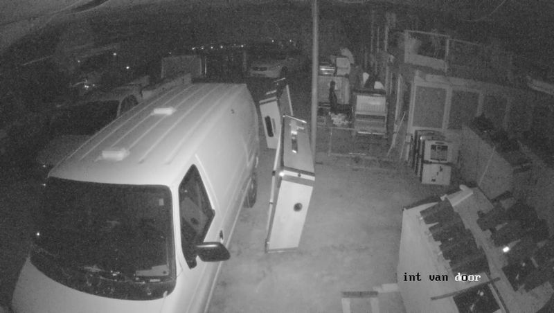

Same building same WDR reset, camera mounted on a WMS110 mount onto a steel pole. DS-2CD2142FWD-IS, 74ft of cat6 POE off the same switch.
again 1 hour after turning WDR off and back on

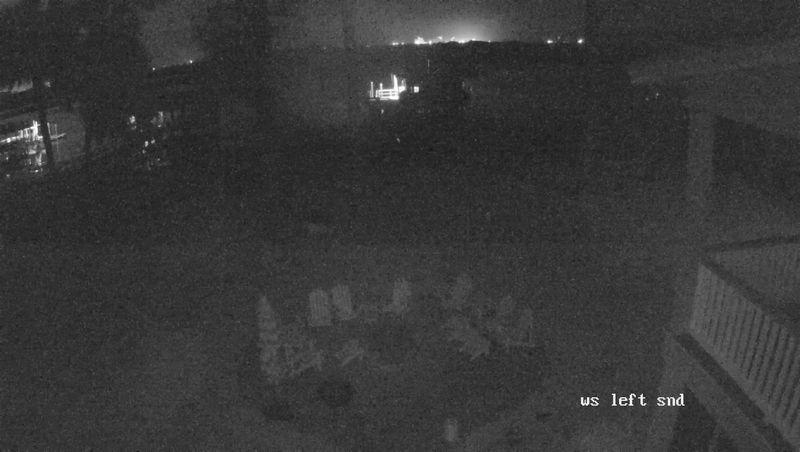

Another location that I do not have an after picture for since I have not been back out recently, this is a week or so after I turned WDR on, the picture was dark but clear for the first couple days
DS-2CD2542FWD-IS , POE from DS-7716NI-SP, mounted on the side of the house, 46ft cat6
