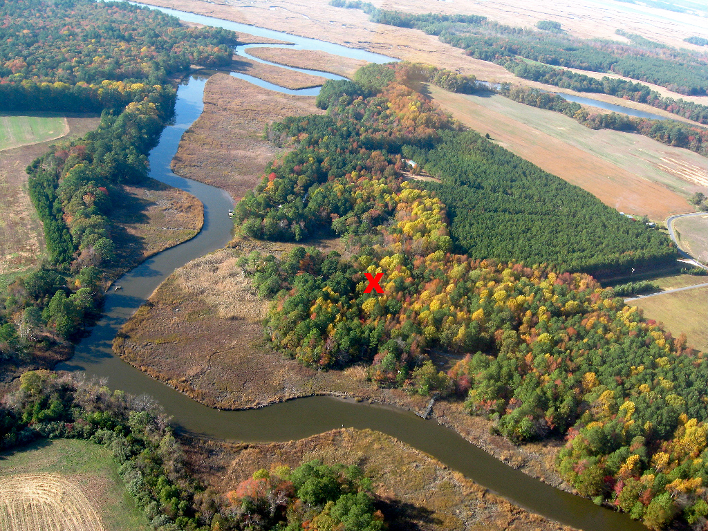

Wetstuff 0 Posted February 27, 2017 Thanks, Matt. I should have stated first that I'm a newbie with newbie experiences. I set up a simple system with an inexpensive Chinese NVR and two cameras. 'It worked.' ..but left a lot to be desired. Its true failings came in when I hooked 30+30+10 meter cables in series resulting in an image that resembled an abstract painting rather that a quality photograph. I cannot use WiFi because I am in woods, and most of the things I would like to see are not close to the house.. To answer your question: Yes, I could use the TV as a monitor for the NVR. The concern is: if the quality of the NVR has a dramatic effect on the image, would it not be better if there was a Y-junction (my word) to send a pure signal to the TV and a second to the NVR, rather than get a possibly degraded signal from the NVT-to-TV? Thanks. Jim Share this post Link to post Share on other sites

Wetstuff 0 Posted February 28, 2017 Negative on the IP cams, Matt. We are in an area where there is no Cable and the closest cell tower is ~7mi. My first system is/was a basic 4 channel NVR with two cams - the type not powered/imaged via LAN cable ...cameras with an individual 110v power supply+BNC connectors. A new system I want to install should include: a good screen/TV, good cabling, a NVR and at least one good cam. So far I have found the TV mentioned above ..CAT6 at a good price (monoprice.com) ..and am looking at this 5meg cam on Amazon —GW Security 5MP 2592 x 1920 Pixel Super HD 1920P. (1080p@30fps) I have been a mfr. of aircraft accessories (non-electrical) for 30+yrs so am pretty used to creating/solving problems and sourcing. My wife's idea would be; "Just call someone." ..but, I can't do that —it's not in my nature. Jim Share this post Link to post Share on other sites
