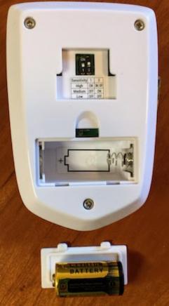

The back of the PIR sensor contains the unit’s battery compartment and a set of DIP switches allowing one to select the module’s sensitivity level. This is often modified when someone has pets or other smaller objects which might set off a motion event.
Figure 12: PIR Back and Switch View
One can see in the below photo that it is very easy to set the sensitivity to one of three permitted setting; high, medium, and low. High means the camera will more easily pick up small motion events (very sensitive) to Low (not very sensitive) is used to only alert when a large portion of the PIR’s view detects motion.
Figure 13: PIR Switch Close-up
The following is an view of the PIR unit with its battery compartment opened along with the provided lithium battery. A very simply unit to work with and configure. The additional packaging gives the user many different options of mounting the PIR module. It can be mounted using the provided screws or double sided tape. The mounting bracket slides into the two slots covering up the DIP switches when mounted. However, once the sensitivity is set, this unit is mostly a set it and forget it piece.
Figure 14: PIR Back and Battery Compartment
