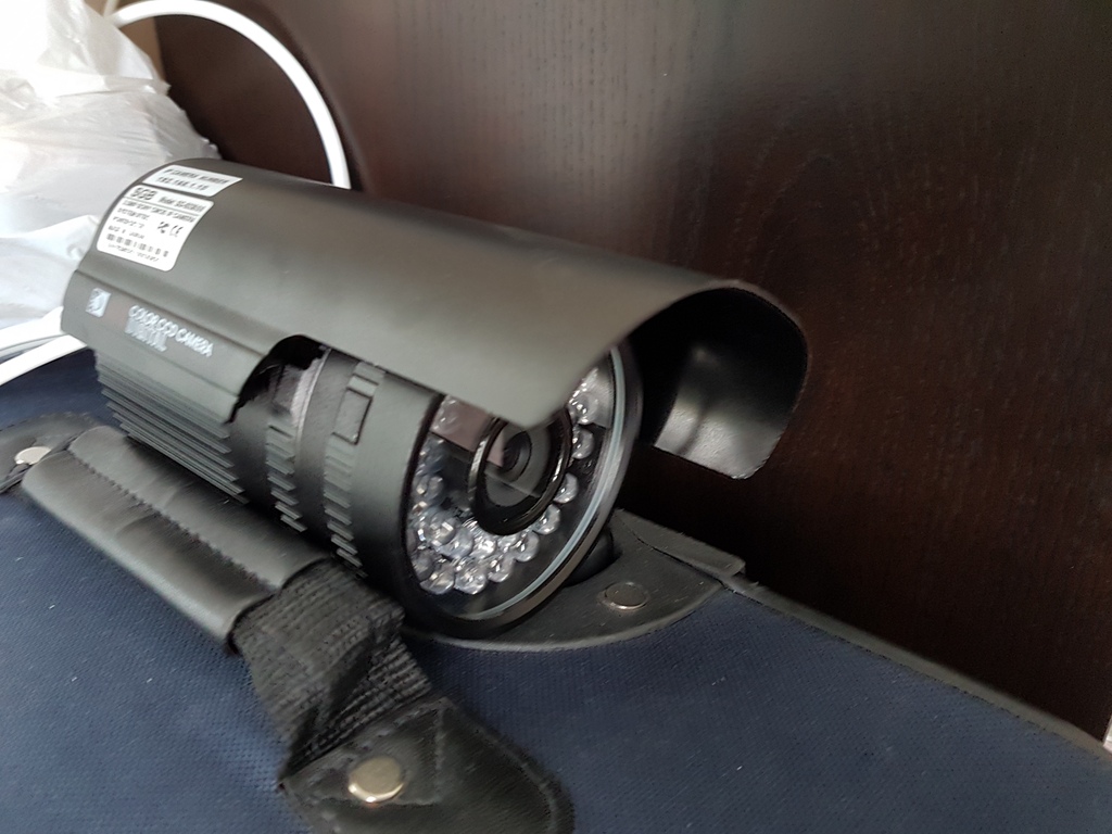

Aaron407 0 Posted June 11, 2017 Hi everybody, I'm a new member to the board, mostly because I can't seem to figure out URL formatting for accessing my cameras. I picked up a cheap chinese IP camera (I know, first mistake...) with virtually no documentation. They came with a link to the standard CMS software, which I can use to access the stream without any issue. The stream is stable and uses the standard media port (8086 in my case). I can also find the stream using the Android vmEyeSuper HD app, with a strong and stable stream with the same local IP and port number. They work even when RTSP is disabled in the camera. The problem is that I can't get iSpy to access through that port, presumably due to not knowing how to format the url. I have tried all of the generic formats for http, but nothing wants to connect. I can connect via RTSP and ONVIF, but I have found that there are many stream disconnections and poor FPS, while the stream in the CMS application stays strong at the same time, presumably with HTTP access. What I'm trying to determine is what URL either CMS or vmEyeSuper HD are actually using for accessing the camera. I have dug into it through wireshark, but that only shows the IP address and port for the request, but not the full call address. Can anyone suggest how to determine this URL? I've been banging my head against the wall for days trying to figure it out, but haven't had any luck. Any help would be greatly appreciated! Share this post Link to post Share on other sites

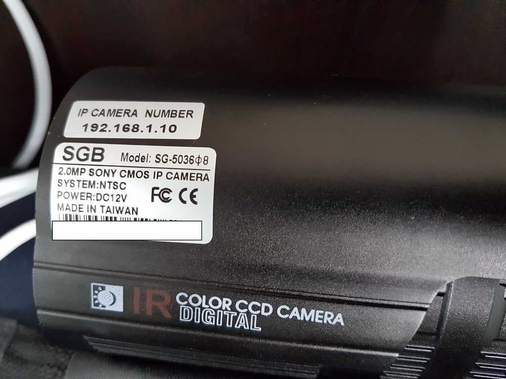

Aaron407 0 Posted June 13, 2017 Thanks for the responses guys. The camera does have a label as noted below, but it hasn't really helped me to track anything down. SGB Model: SG-5036?8 2.0MP SONY CMOS IP CAMERA SYSTEM: NTSC POWER: DC12V MADE IN TAIWAN Beyond that, the only other labeling on the camera is a sticker with the default local IP address, and a “logo” of sorts stating “IR COLOR CCD CAMERA DIGITAL”. All settings for the camera seem to have to be made through the CMS software, but I haven't been able to find a firmware version for the camera itself. I would assume from the "SGB" ahead of the model number that it would be considered the manufacturer, but I haven't been able to find an associated website. iSpy also doesn't have SGB listed as a make. As for the ip address post, thanks, but I do indeed have that side covered, and it's just finding the http stream URL that is causing me grief. Share this post Link to post Share on other sites
