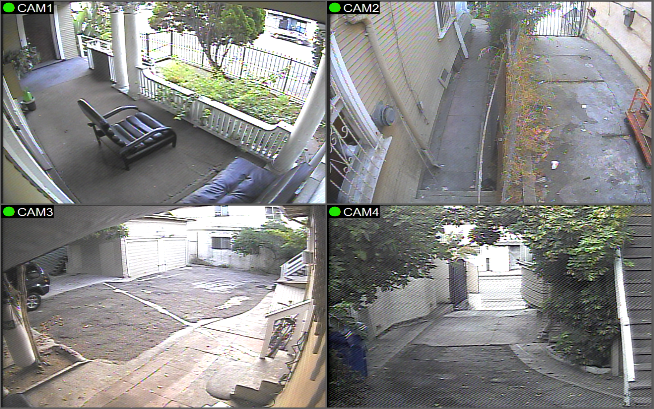

Roman.CA 0 Posted July 22, 2017 You need the powerful CPU if you use the H.265 feature. It will cut your storage and network requirments in half. Approximately what hard drive size we are talking about and what CPU spec is there some online calculator i could use for the server specs? If H.264/265 encoding going on in the camera before signal is transmitted over Ethernet why cant data from camera be saved directly to the server HDD without need to use CPU to encode/decode if i don t need live view. Why are you recording 24/7? Most people only record on motion. I wish i could use motion detection, however i have worst possible environment for motion detection i tried in the past. Trees move, even if i exclude them from motion area sun reflects tree shadow in every direction during the day and shadow moves when wind blows on the trees, leafs and dust flying when wind is strong, cars drive by and headlights light the porch creating movement, insects fly into camera attracted by IR light, all this triggers recording frequently. Why are you recording 24/7? Most people only record on motion. Aside from the huge storage requirements of 24/7 recording, if there is an incident that you have to research, you end up with many many hours of insignificant recordings to review to find the incident. With motion detection I had as much of events to go trough as if i had a 24/7 recorder, if i lower motion detection sensitivity then something happens and i don't even have recording for it half of the times. Perhaps if i use motion detection feature while recording 24/7 i will get entries in "Alarm Event" log with time so i can navigate trough them if something. Share this post Link to post Share on other sites
