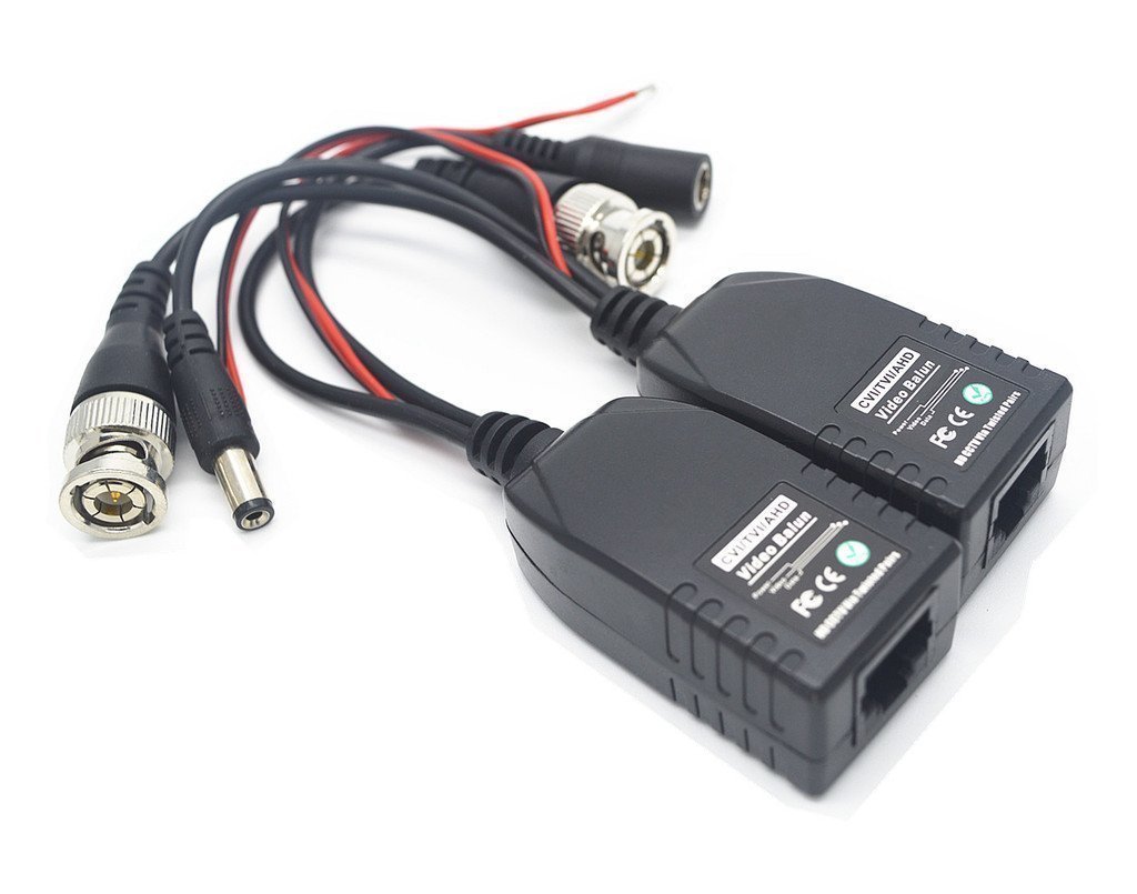

Thanks for the reply. I ended up buying a SUNBA 3X Optical Zoom mini ptz as only needed a small one and I have had an Qvis i-zeus DVR for a good few years now. I also purchased some cat5e and 2 pairs of cat 5e ethernet baluns, one pair had the ptz cables as well on them and the other pair had no ptz wires on. I rewired both the cameras with cat 5e one of them was a 5 meter run for the bullet camera and the other was a 23 meter run with the ptz.
I did the work over the weekend but had to mess around with the end of the ethernet cable for a while to get it right but now both are working and after messing with the ptz wires for 2 hours I had them wrong way round in the A/B on the DVR but after correcting the issue the ptz function worked fine for moving the camera around.
Now the only thing is the camera that was on a 23 meter run has lines running down the screen and the other one on a 5-meter run has some lines running down the screen too but not as bad as the longest running cable. Now I'm guessing this could be caused as the cables are too thin in the ethernet to properly power the devices may be as I tried the long run ptz camera on a shorter 3 meter run of power and no lines but I'm baffled with the 5 meter run as that has lines on off such a short run.
I was thinking of taking the baluns off and using 2 twisted pairs as the power if it is the power causing the lines through the screen it's not bad but its enough to p*ss you off XD.
So can anyone confirm that ethernet cable using these baluns below are not the best as they cause lines if so i will have to figure something else out or live with the lines to save another weekend cctv headache..
