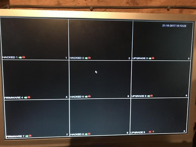

All cameras colour/contrast settings set so that showing black instead of camera picture (although camera still working if reset contrast etc..

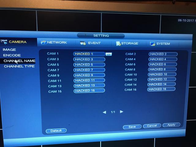

Each camera name changed to ‘HACKED’

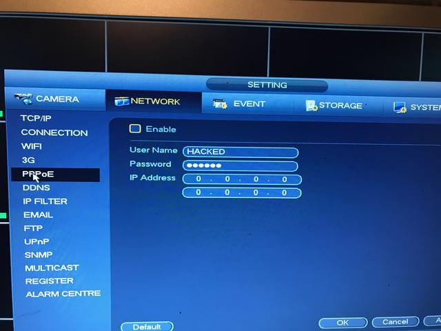

Network settings changed as in pic below.
PPPoE username and password changed

All was ok for a few days and then I was HACKED again in exactly the same way except that the cameras were mostly renamed to HACKED but one ws named Upgrade and one named firmware.
It was almost as if someone was telling me that they had hacked me and that I needed to update my firmware.

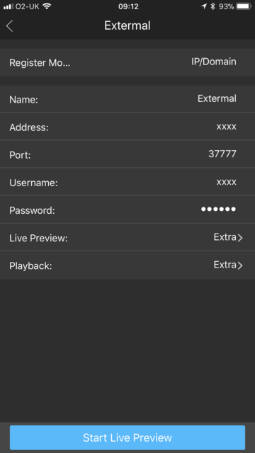

So I only need to access my cctv from two mobile phones via app IDMSS plus. In this app I only and the only port that I enter on the app is 37777 303051_1.png, does that mean that this is the only port that I need to forward on my router in order to get the live view on my mobile or would the app need to use other ports such as 554 to make the live view appear (and port number is invisbly embedded n the code of the app or something?

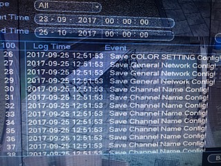

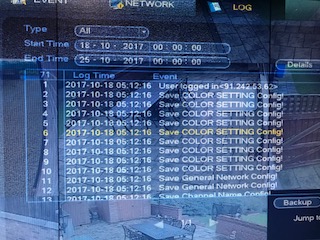

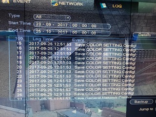

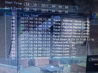

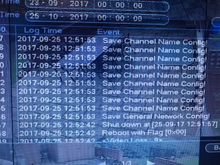

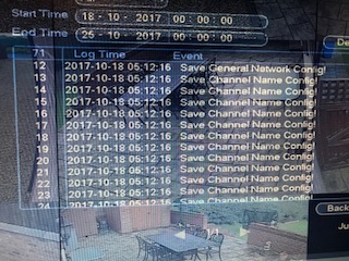

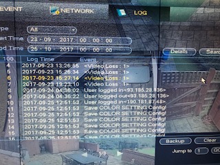

I have looked at the logs and this is the first time I was hacked. The day before some IP in Russia logged in and out and then the next day was hacked by IP address in Argentina
Then hacked again IP address in Ukraine. This time changing names of cameras with message to update firmware? - friendly hacker?

Hi. You only need to forward port 37777 and don’t portforward anything else.
