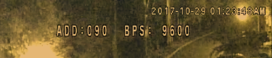

Mitch619911 0 Posted October 31, 2017 I have had my PTZ camera for a good year and ran it on 2 systems (old and new) just fine. I just installed the new system and hooked up my PTZ camera, it's been working for a good month, but now it has stopped. Here is what I last did (I think it locked it up by doing this) I logged on to their cheap Chinese made website 'xmyeye' and went to the preset area, added a preset (90) and tried to save it and start a tour mode, right after I put in the preset it made my PTZ camera bring up like a menu then at that point it stopped working (video works, no PTZ controls), I bought a PTZ joystick and hooked it straight into the PTZ camera, still nothing. Heres a picture of what the system said after I hit the preset: I have tried to factory reset the DVR, this did nothing but I did notice the preset stayed the same, my PTZ camera does not have a factory reset button (or any button), I took the damn thing apart looking for one, found nothing but circuit boards...Also, I left it unplugged for tonight, gonna try to leave it like that for a day or two, maybe it will reset itself? My camera: http://r.ebay.com/hqEnd3 My DVR: http://a.co/eOcQoQa My PTZ joystick: http://a.co/8NVG8sQ Thank you for any help. Share this post Link to post Share on other sites

Mitch619911 0 Posted October 31, 2017 On the joystick you need to change cam (address) to 90 The "ADD: 090" is the preset I was trying to program in, I believe, on the dip switches I have number 2 up, and number 10 up. Address: 2 PELCO-D: 10 (on/up) Share this post Link to post Share on other sites

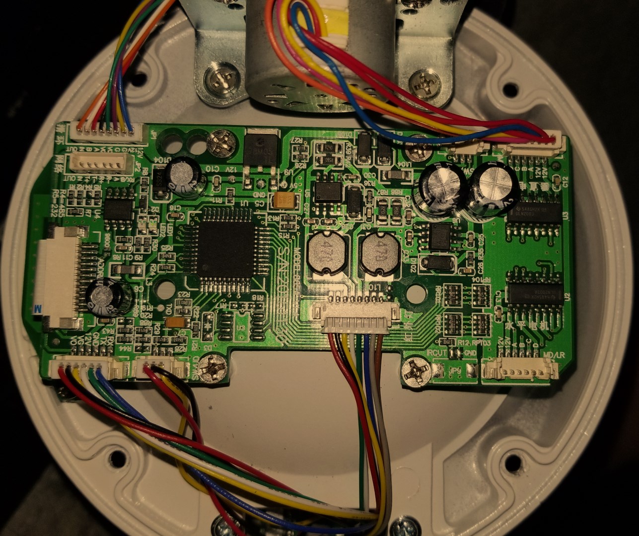

Mitch619911 0 Posted November 1, 2017 I opened the PTZ camera back up again and found that when I try to move the PTZ camera with the joystick, on the circuit board an LED flashes dimly! Share this post Link to post Share on other sites

Mitch619911 0 Posted November 4, 2017 Okay when starting up the ptz camera it does it spin and boot up and on screen it says the Add 090 BR: thing in the first post screenshot Share this post Link to post Share on other sites
Mitch619911 0 Posted November 4, 2017 Here is the main brain I belive. Share this post Link to post Share on other sites
