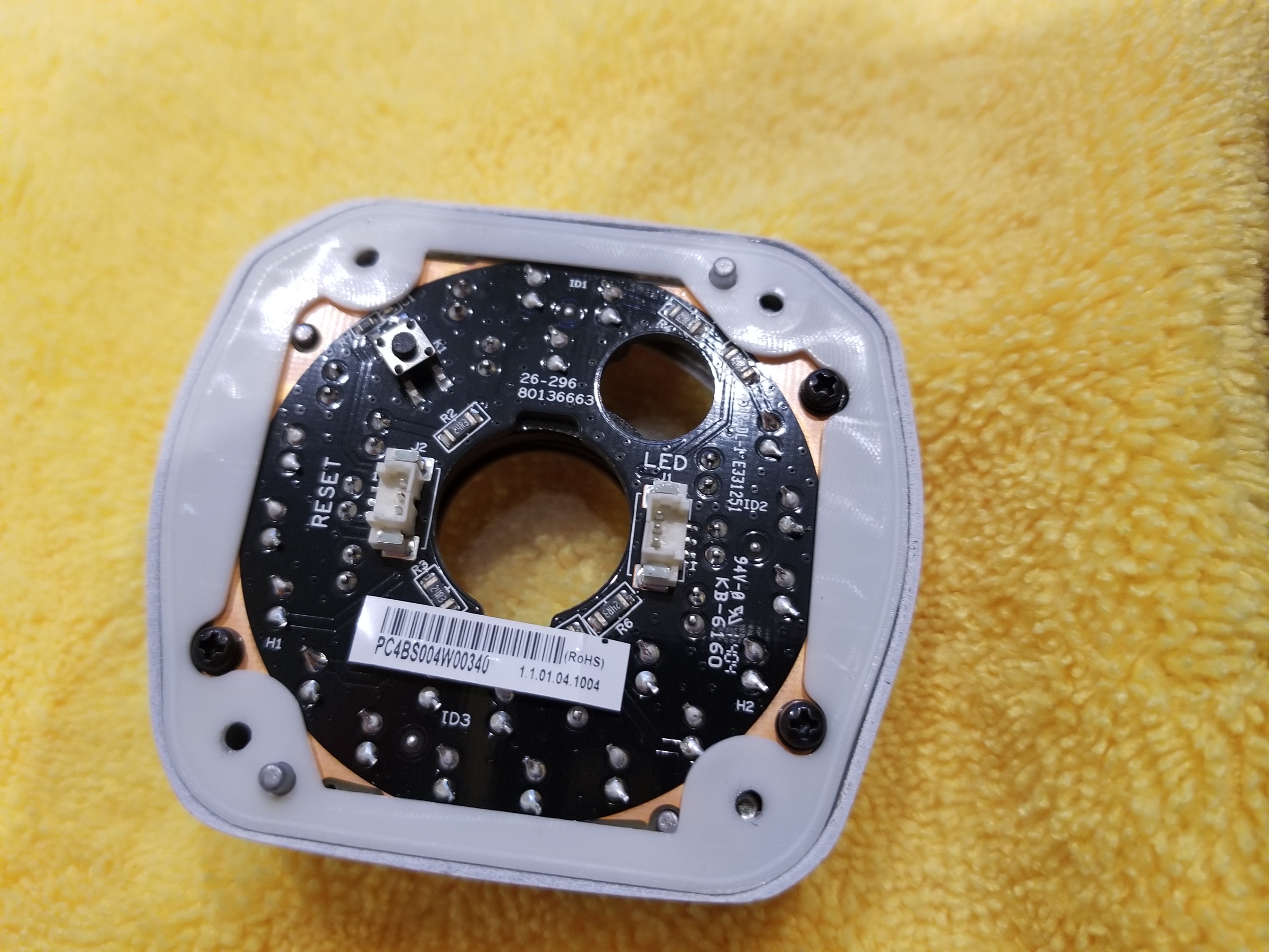

puppyfrog 0 Posted June 5, 2018 Got a couple of photos of the inside on the camera. Is anyone who is able to help identify the Dahua equivalent? Many thanks, in advance. I really need to try a Dahua firmware on this as the Q-See one has a ton of issues. Share this post Link to post Share on other sites
