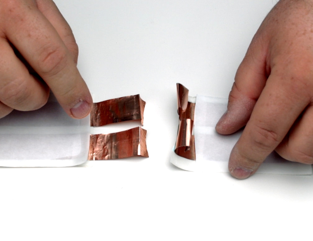

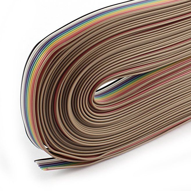

I could use "flexible flat cable" (FFC tape)?
They do make them completely flat, but can i put 12v trough it safely?

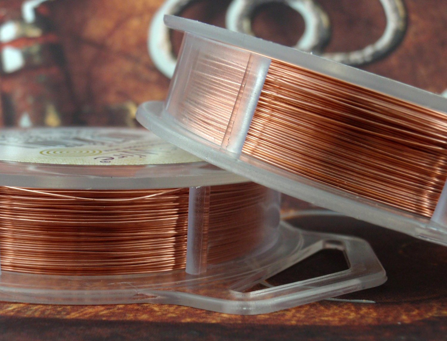

Can i use thin bare (without shielding) cooper wire just bury into wall and paint over it, this wont be a fire hazard running 12 volts over it wont heart it up too much since CCTV cameras don't draw that much amps.
Whats the minimal gauge (diameter) of cable to run like 10ft and still have decent signal?

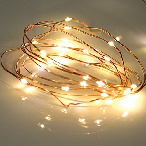

LED do use them and pretty sure they draw more power than cctv camera.

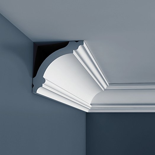

Use cat5 and cover cable with moulding
