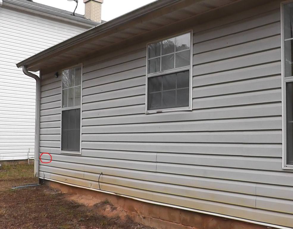

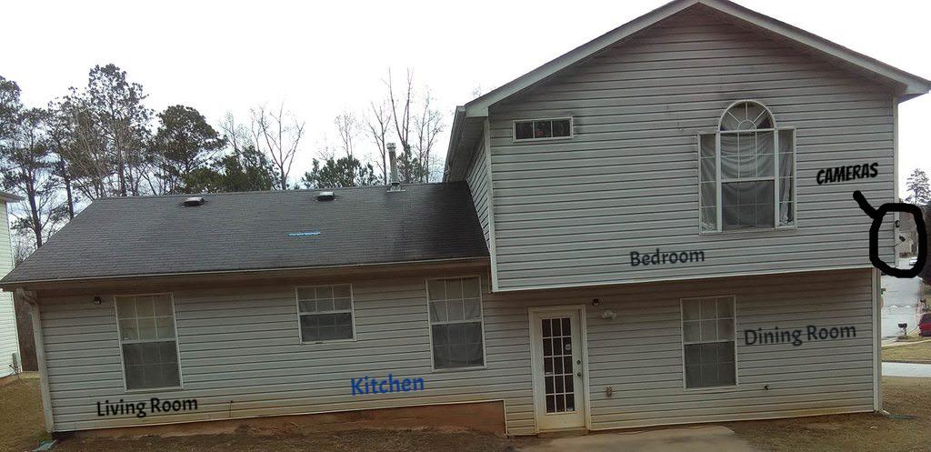

Lavender90 0 Posted December 20, 2017 Use a spade bit from the outside going in, find a spade bit size hole that would fit all of your cables ( rem the heads are bigger than the cable). Also since the cables are coming out from that low, will you be using conduit pipe? I thank you for responding, but may I request more information please. I have read from different articles that drilling in vinyl siding must be completed with caution, including in cold weather which is present here in Georgia currently. I have a 3/4 Spade bit, so I will search what is the best method of drilling in to vinyl siding when the weather is cold. No, I have decided to not use a conduit pipe. Share this post Link to post Share on other sites
tomcctv 190 Posted December 20, 2017 Hi. I would remove drain down pipe and drill hole that way you won’t see cables once drain pipe is re fitted. I would not do to much reading ...... I don’t see why anyone would think there is a problem drilling cold siding....... drill bit will generate heat as soon as you start to drill Share this post Link to post Share on other sites
Lavender90 0 Posted December 21, 2017 Hi. I would remove drain down pipe and drill hole that way you won’t see cables once drain pipe is re fitted. I would not do to much reading ...... I don’t see why anyone would think there is a problem drilling cold siding....... drill bit will generate heat as soon as you start to drill Thank you for commenting tomcctv. I did not think to drill there, so I will consider the suggestion. I will use my stud finder and hope no wires or beams are near the drain pipe. I only want to search for answers carefully so I do not make any errors, as this is my first time with installing cameras. Share this post Link to post Share on other sites

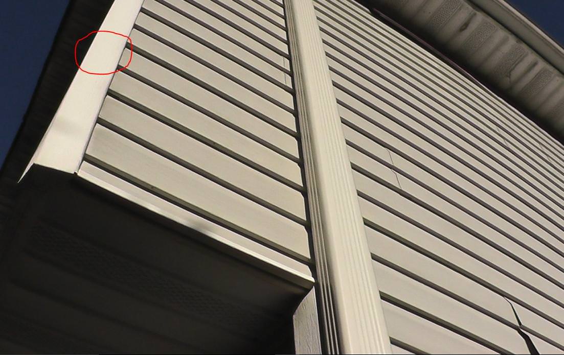

CYANiDE 0 Posted December 28, 2017 Lift up the siding and you should have only one or two main penetrations going outside. You can hide all the cabling behind the siding pretty easily, just use outdoor rated cable. What exactly are you worried about? Share this post Link to post Share on other sites
Lavender90 0 Posted January 11, 2018 Lift up the siding and you should have only one or two main penetrations going outside. You can hide all the cabling behind the siding pretty easily, just use outdoor rated cable. What exactly are you worried about? I thank you for responding, I will consider your suggestion once I begin installing next week. I only want to be informed since this will be me and my siblings first time installing cameras to our house, and I do not want to make any mistakes to add more damage since our house was damaged in the past by teenagers. May I ask if do begin drilling, do begin inside or outside first? Edit: I am editing to add more detailed picture of the back yard, I hope this will be more of an assistance. Share this post Link to post Share on other sites
jeromephone 6 Posted January 11, 2018 outside in drilling usually as you do not want to push the siding away from the house. You do need to measure so you are sure were you are going to come out inside. Share this post Link to post Share on other sites
Lavender90 0 Posted January 12, 2018 outside in drilling usually as you do not want to push the siding away from the house. You do need to measure so you are sure were you are going to come out inside. I thank you for responding. May I ask do I drill the vinyl siding at a slow setting (if possible), and do I need a conduit? I have purchased vinyl siding clips since I was not aware if I would need the conduit or not. Share this post Link to post Share on other sites
CYANiDE 0 Posted January 12, 2018 outside in drilling usually as you do not want to push the siding away from the house. You do need to measure so you are sure were you are going to come out inside. I thank you for responding. May I ask do I drill the vinyl siding at a slow setting (if possible), and do I need a conduit? I have purchased vinyl siding clips since I was not aware if I would need the conduit or not. Note: Only drill the siding where you are mounting cameras not just to get the cable through. You should keep the holes underneath the siding as much as possible. How many cameras are you installing and where on the house are you mounting them? Share this post Link to post Share on other sites
Lavender90 0 Posted January 14, 2018 I thank you for responding. May I ask do I drill the vinyl siding at a slow setting (if possible), and do I need a conduit? I have purchased vinyl siding clips since I was not aware if I would need the conduit or not. Note: Only drill the siding where you are mounting cameras not just to get the cable through. You should keep the holes underneath the siding as much as possible. How many cameras are you installing and where on the house are you mounting them? I apologise for not mentioning the number, I have four cameras total. I am aware of the locations I want to place the cameras, with three being mounted on the siding trim on our house since I noticed a neighbor has done this for his cameras. I have taken an example picture to show: I did not purchase a mounting plate yet, as I thought my neighbor's method was easier. He only suggested that I drill where I want to insert the cables through the vinyl, but for a beginner as me I am hoping to receive more helpful guidance please. I have some equipment currently (Drill, siding clips, siding removal tool, stud finder, caulk), but what has me hesitant to begin is what to do properly. How do I drill and not damage the vinyl siding or can placing the cables under the vinyl and drill a hole for the cables possible? Share this post Link to post Share on other sites

b1gbleu 0 Posted January 29, 2018 Lavender90, As others have cautioned about drilling in the cold, you could split the siding as the drill is pushing out instead of a neat hole being drilled. Another problem with drilling from the inside is you usually cannot mount anything exactly where the wire pops out. If you push on the siding with your finger you will notice it's relatively loose. Only the outside corners are stiff. Share this post Link to post Share on other sites
