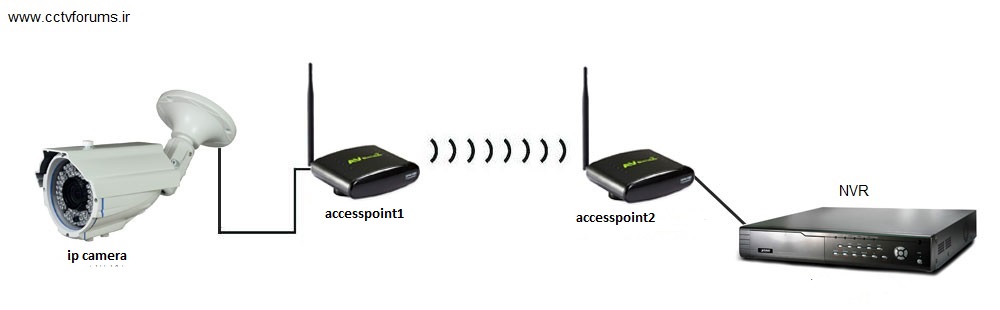

lakers320 0 Posted January 26, 2018 hello guys How to connect an access point to nvr for wireless connection between nvr and ipcamera Like the figure below Please explain about the setting thanks Share this post Link to post Share on other sites
TheF 0 Posted January 29, 2018 All items in your netwrok needs to have the same IP-range. This is very important. Start with your access points. To make it easy, set them up on your desk, next to eachother. Choose one of them and connect your computer/laptop to it. Obtain IP adress from the access point and enter it's web interface. Make a note of which IP your computer gets. Set it up to broadcast with an SSID and password of your choice. This is the one you connect your DVR to. I advice you to write down that info. Connect your computer to the other access point and enter it's web interface. Set it to connect to the SSID/password you set on the previous access point. This is the one you connect your camera to. When connecting the IP camera, make sure to set it to manual IP adress within the same range as the access points. When connecting the DVR camera, make sure to set it to manual IP adress within the same range as the access points. Program the DVR to receive video stream from the camera's IP adress. If it does not work, temporary connect the camera directly to the DVR. Share this post Link to post Share on other sites
