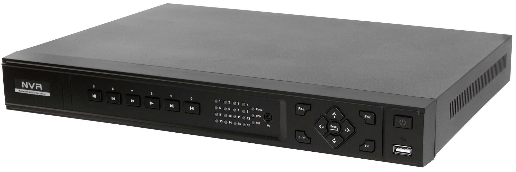

mrbordello 0 Posted February 3, 2018 Hello , i install on my old NVR from DAHUA , its Resailer version from Avaloid . Firmware update from Dahua , the NVR accepted the update file , yet it doenst boot any more. the firmware is on a 25L128 chip i have spi programmer and read the 16mb . any1 have full backup from a Dahua 16x NVR or i had to try to rebuild firmware when i extract the bin file with 7zip . i have boot loader firmware in each parts any1 knows the layout. Share this post Link to post Share on other sites
mrbordello 0 Posted February 9, 2018 NVR is working again . I read Fullbackup with SPI Flasher from Same Working model . I Edit than on HEX editor the Mac Adress that no Problems on Dahua P2P service , because Same Serial . Flash the Edit_Working Backup with SPI and Recorder Works good Thanks . Share this post Link to post Share on other sites
