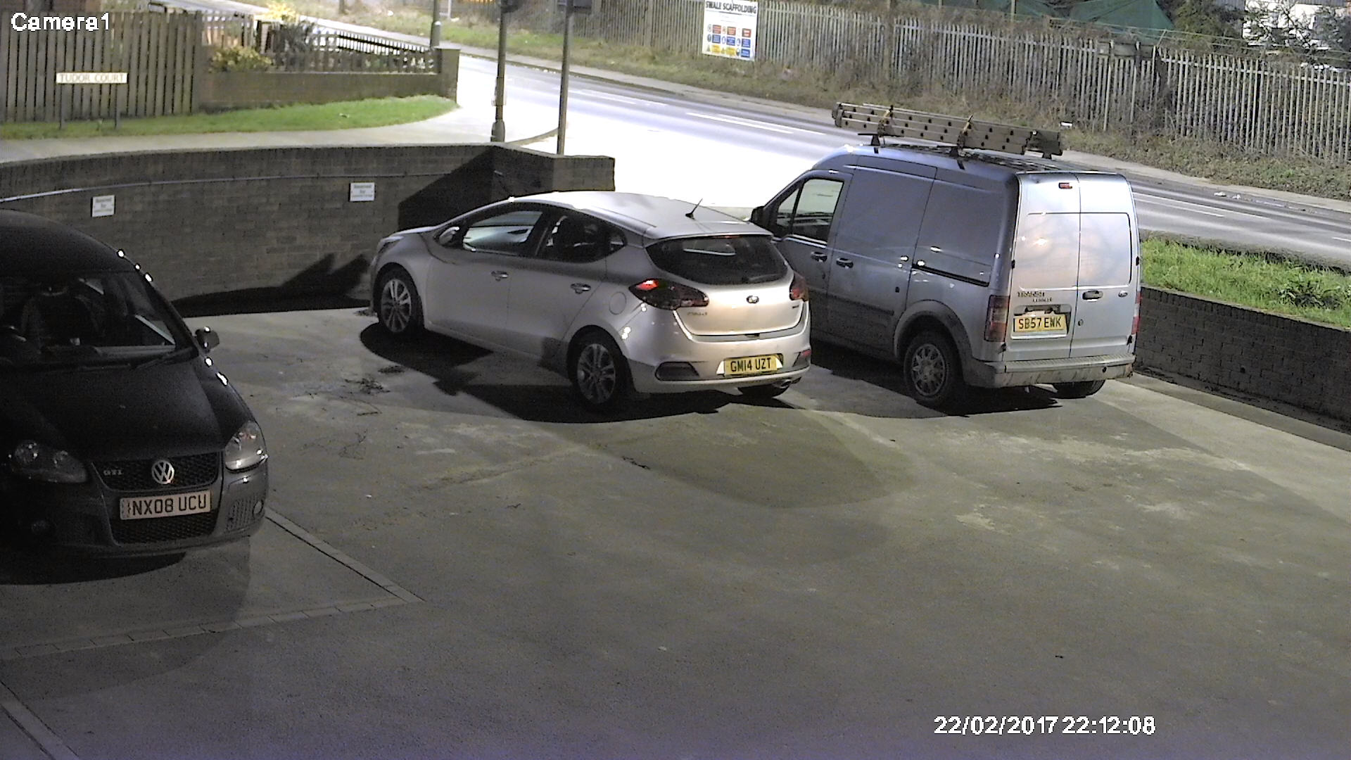

desieinstein 0 Posted July 20, 2018 Hi When well lit: https://www.cctvfirst.co.uk/images/www.cctvfirst.co.uk/rot/img/59a69037c88ea.jpg https://www.cctvfirst.co.uk/images/www.cctvfirst.co.uk/static/Sony%20Starvis_1.jpg Do you recon then I should go with the Hikvision system? Regards Share this post Link to post Share on other sites

tomcctv 190 Posted July 20, 2018 There are 100s of posts about gray market hik Also your posted pictures ..... It has car park lighting ... That is not a true image of a lowlight camera. Share this post Link to post Share on other sites
