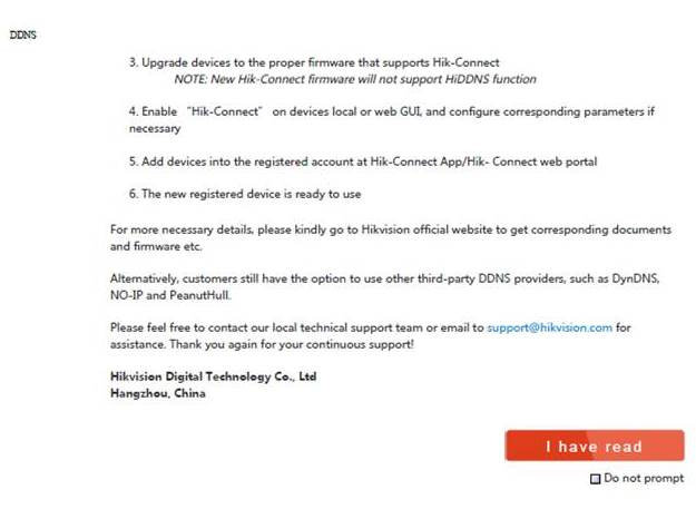

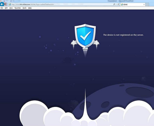

I went thru a bit of troubleshooting, and am thinking that the issue is related to the DDNS upgrade that required devices to be registered at hik-online.com. I went thru the steps on the site, but haven't been able to register the camera. Below are some screen shots of the pages / errors that I'm receiving. Hopefully someone can give me some direction / assistance.
These are the pages that come up when I go to "www.hik-online.com/dar124".

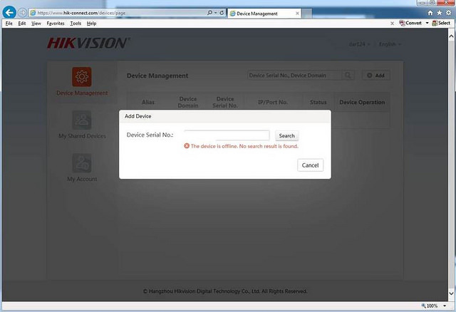

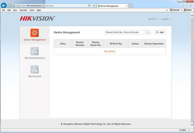

Then when I go to the new "www.hik-connect.com" site and log in to try to add my camera with it's serial number I get the error that the device is offline.
The camera still lights up red at night, so I know it's getting power. I did borrow a new POE injector from work and I get the same results. I'm trying to avoid removing the camera from the house, as it was kinda tricky to get everything wired up behind the siding. I would also be ok w/ doing some sort of "reset" on the camera and starting the config from fresh from the beginning (if that's possible??)

The Hik ddns server is being discontinued, so you will need to update your camera Firmware for you to enable the Hik connect function,if your model camera allows this , its almost like a P2P connection, camera must have this function for it to work on the Hik connect server
other option will be do get a new Hikvision NVR with the Hik connect function on , all the new models will have this , then connect the camera to the NVR and view the NVR on the app
also you could purchase a ddns domain , through dyn.com for example then do port forwarding on you router (if your ISP allows ) and view your cameras remotely that way, I would recommend changing the default port of 8000 and use a secure password, but it will work
hope this helps
regards
