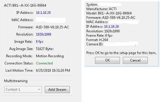

Lastly, just to give you the specs for the camera. Here's what I can get from the DVR for it:
Do you have any idea how to fix this?
