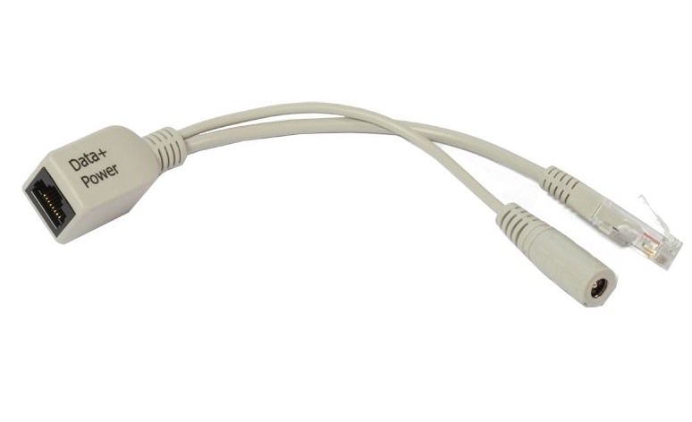

I have an IP CAMERA (several different models) with both PoE Support and DC 12v connector.
Using a regular 12v 2A DC Adapter directly connected to it works fine.
I wanted to make use of the PoE Support but i dont have PoE Power Supply
I do have
1. Passive PoE Injector Cables
2. regular 12v DC power adapters for CCTV equipment
Connecting the PoE injector to the PoE Port of the device using a straight through UTP cable, DOESn'T WORK.

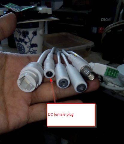

but i have also another dilema
1. If we use a voltage tester on the PoE Splitter side , not a single volt of power is detected
this is the case for both straight through and cross over crimping
2. if we connect the LAN cable direct to LAN port of camera , still no power (coz i assume the camera doesn't have BUILT IN poe support since it has connector cables for DC plug)
see pic
what are we doing wrong here?
