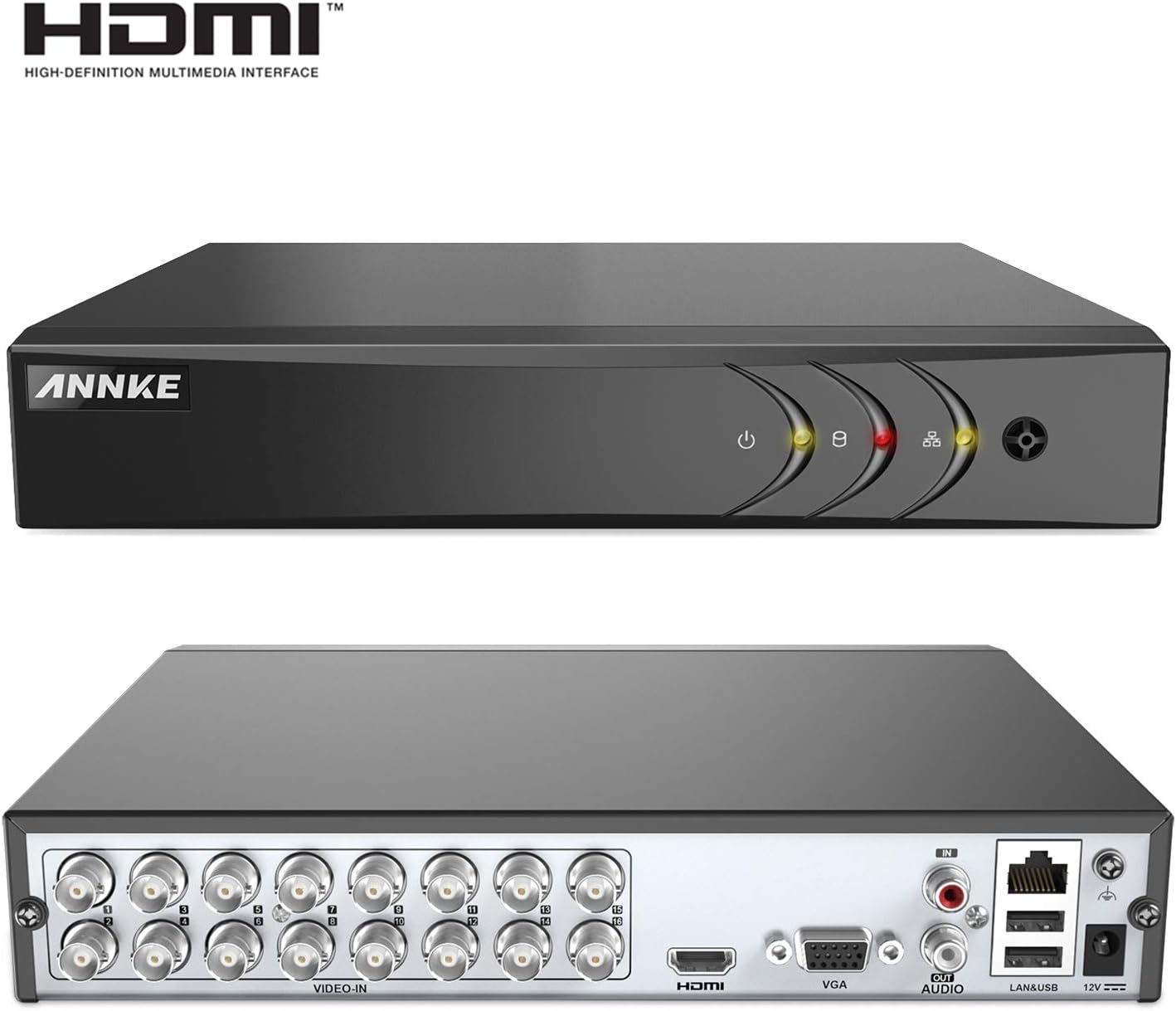

larry1301 1 Posted January 20, 2021 One like this seems to do what I need although I haven't been about to find out the difference yet between 5MP and 5MP Lite. https://www.amazon.com/ANNKE-16-Channel-Security-Surveillance-Detection/dp/B08BC6V7S1/ref=sr_1_18?dchild=1&keywords=16+channel+dvr+5mp&qid=1611178535&sr=8-18. Doesn't seem to be a lot of 16CH DVRs without cameras out there. I see more 8CH. Share this post Link to post Share on other sites
tomcctv 190 Posted January 20, 2021 Hi that’s cheap for a reason ....... app only shows 1 camera at a time and app has problems Share this post Link to post Share on other sites
