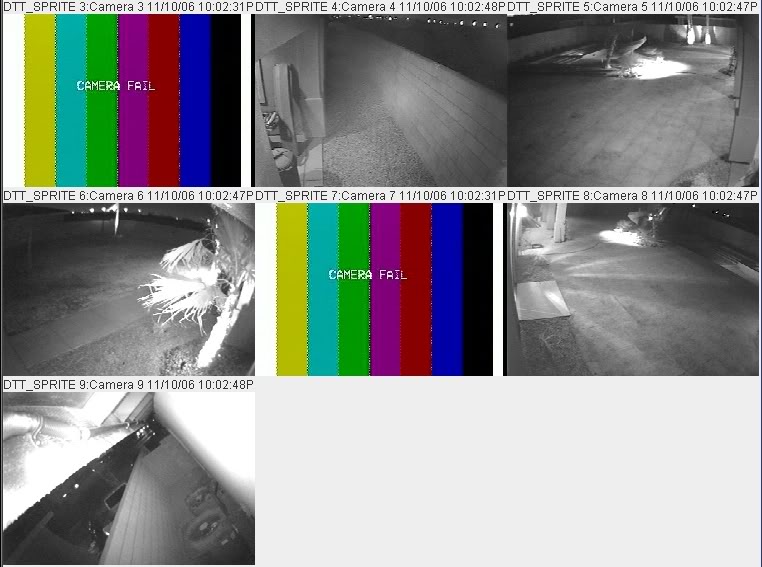

DeathtoToasters1 0 Posted November 10, 2006 Here is a pic of the new cameras. The last picture still needs to be positioned correctly....that is why it is turned the wrong way. Share this post Link to post Share on other sites
rory 0 Posted November 10, 2006 Cool .. any day images .. also lets see them when they are all on where is the pool though? Share this post Link to post Share on other sites

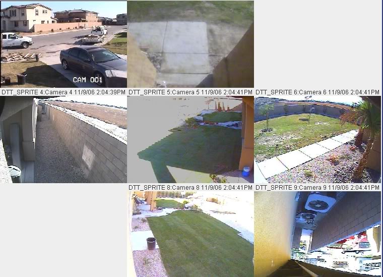

DeathtoToasters1 0 Posted November 10, 2006 The top and middle row, far right pictures are the two views of the back yard. On the top picture the pool is in the upper left corner. On the middle right hand picture it is on the upper right hand corner. You can only see half of it. Here are some day pics: The upper left hand corner pic is from a PTZ I have installed. The pool glare pic is the middle row, middle pic and then middle pic, third row on the upper right corner. You can see the glare and basic lack of ANY picture from that location. Advice? Share this post Link to post Share on other sites
rory 0 Posted November 10, 2006 the center pic, looks like the iris is open too much .. or the AGC is on SAGC .. try adjusting that ... also check the DVR settings .. they also have AGC in some of them .. or bad connection, bad DVR port, or bad camera .. have you tested each one on an analog monitor first? (CCTV Monitor or TV) Share this post Link to post Share on other sites

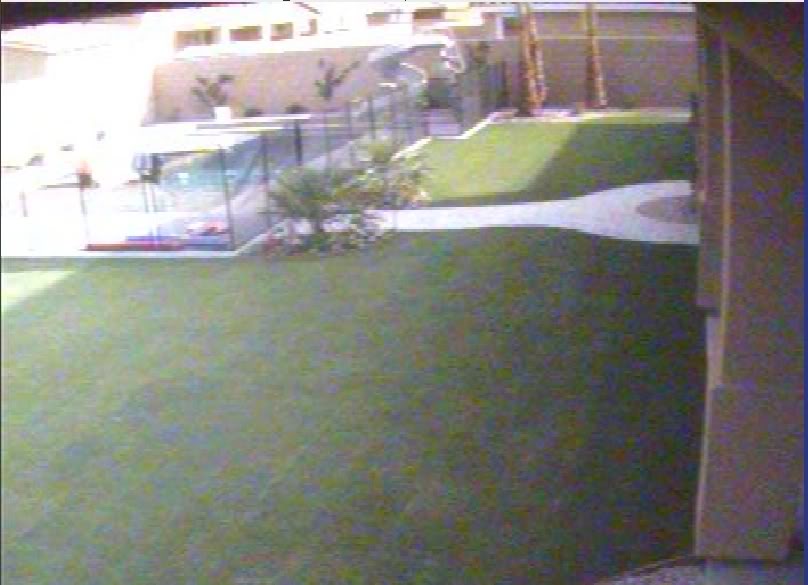

DeathtoToasters1 0 Posted November 22, 2006 rory said: the center pic, looks like the iris is open too much .. or the AGC is on SAGC .. try adjusting that ... also check the DVR settings .. they also have AGC in some of them .. or bad connection, bad DVR port, or bad camera .. have you tested each one on an analog monitor first? (CCTV Monitor or TV) Here is an update pic: I adjusted the dip switches as suggested, and did the iris (little dial thingy) and this was the best I could do. Trying to adjust that little dial took me over an hour!! Even a little turn made it black or the looking into the sun. Well anyway it is slightly better. Thoughts? Share this post Link to post Share on other sites
CollinR 0 Posted November 22, 2006 Somethings up that image is 808x585, looks like it needs refocusing too. Share this post Link to post Share on other sites
jisaac 0 Posted November 22, 2006 why dont you try to to put one of the exact same cameras from the other locations and put it in that one problem area. Then check and see if you are still getting the same issues from the shot. That is a pretty demanding shot of a standard camera. Or try taking the camera down and taking it inside and set it up in normal to low light conditions. If you have an auto iris camera that is working properly then when it goes back into the area of bright light it will check the video level and adjust accordingly. if not well then you need a RMA Share this post Link to post Share on other sites
rory 0 Posted November 22, 2006 Glare and Lightwise it looks better .. Out of 8 Day Night IR Bullets I got here, I also had 1 that has the Iris open too much .. same issue but wasnt as bright .. I guess the Factories just mess up sometimes .. Share this post Link to post Share on other sites

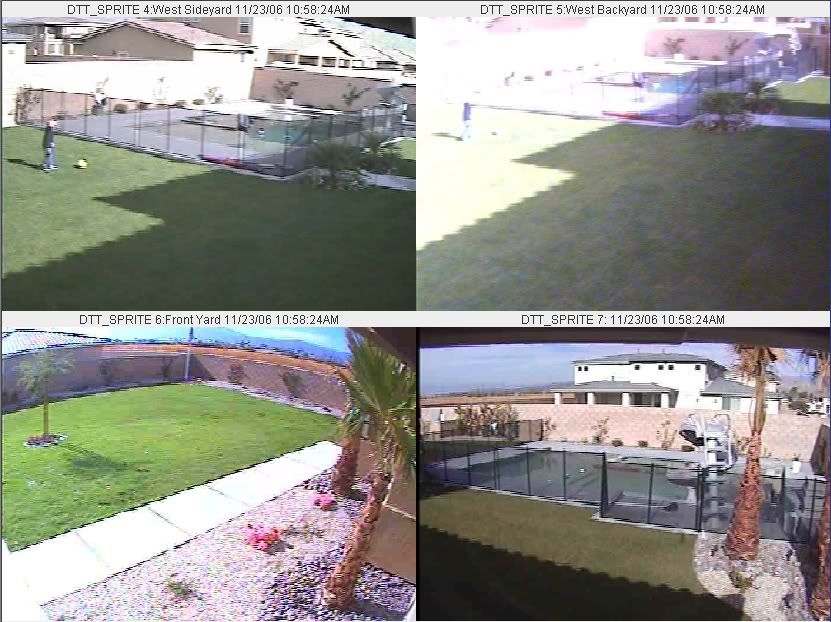

DeathtoToasters1 0 Posted November 23, 2006 Ok, Here we go with some more interesting pics. The upper left picture is a KT&C 600N The upper right picture is the Nuvico NVCC-HW3895IR36N (A direct replacement for the one I had in there yesterday and all the other previous pics with this view) The bottom right is the KT&C KPT-SD301FH. The WDR PTZ dome camera. Obviously the opposite view, which was talked about above. Well from what I see, the KT&C, even though is is cheaper then the Nuvico, has a much better picture on glare. Kinda of surprising. The resolution is also better 550TVL vs 480TVL. Trust me when I say I did my BEST to focus the Nuvico the best I could. Ok....let the expressing of thoughts begin! Share this post Link to post Share on other sites

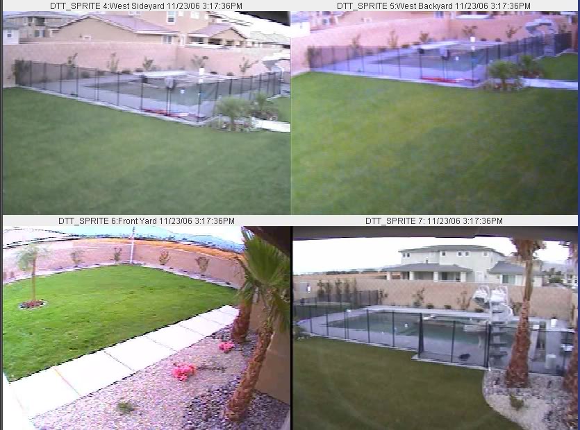

DeathtoToasters1 0 Posted November 23, 2006 Now look at these pics.... Notice the times onthis set and the previous set. Lightly overcast so there is not any direct sunlight on the pool. Share this post Link to post Share on other sites
rory 0 Posted November 24, 2006 DeathtoToasters1 said: The upper left picture is a KT&C 600N The upper right picture is the Nuvico NVCC-HW3895IR36N (A direct replacement for the one I had in there yesterday and all the other previous pics with this view) The bottom right is the KT&C KPT-SD301FH. The WDR PTZ dome camera. Obviously the opposite view, which was talked about above. Well from what I see, the KT&C, even though is is cheaper then the Nuvico, has a much better picture on glare. Kinda of surprising. The resolution is also better 550TVL vs 480TVL. Trust me when I say I did my BEST to focus the Nuvico the best I could. Ok....let the expressing of thoughts begin! Seems like maybe a DVR issue .. did you try switching the port ... put camera 5 on a different input on the DVR .. that amount of light you have there should not cause an issue. Also, are you using 12VDC or 24VAC? Also, Can you run a temporary Coax direct out to that camera location and seewhat it gives .. or just plug in a monitor right to the camera ... I Really doubt its that one camera is better than the other .. my $50 color bullet has a better image than that even with full sunlight right at it. Share this post Link to post Share on other sites
DeathtoToasters1 0 Posted November 24, 2006 rory said: DeathtoToasters1 said: The upper left picture is a KT&C 600N The upper right picture is the Nuvico NVCC-HW3895IR36N (A direct replacement for the one I had in there yesterday and all the other previous pics with this view) The bottom right is the KT&C KPT-SD301FH. The WDR PTZ dome camera. Obviously the opposite view, which was talked about above. Well from what I see, the KT&C, even though is is cheaper then the Nuvico, has a much better picture on glare. Kinda of surprising. The resolution is also better 550TVL vs 480TVL. Trust me when I say I did my BEST to focus the Nuvico the best I could. Ok....let the expressing of thoughts begin! Seems like maybe a DVR issue .. did you try switching the port ... put camera 5 on a different input on the DVR .. that amount of light you have there should not cause an issue. Also, are you using 12VDC or 24VAC? Also, Can you run a temporary Coax direct out to that camera location and seewhat it gives .. or just plug in a monitor right to the camera ... I Really doubt its that one camera is better than the other .. my $50 color bullet has a better image than that even with full sunlight right at it. Everything I am running is 24 volt except for the kt&c camera. I will try and swtich the ports tonight and see if that makes a difference. No I cannot run a new coax out there as it would be a very long piece of coax and unless I plan on digging up my whole yard, I would have no way to make it permament. I can get a monitor and run a short piece of coax just to see if the camera picture looks better on that screen, if that is what you are asking me to try. Is it? So you are saying the glare is still not right...or just the quality if the picture itself? All the cameras seem to look the same, except for the ptz's, but they have auto focus and a bunch of other stuff you all know about. BTW - Happy Thanksgiving to all who celebrate it, and for those who don't, THANKS for the day off! Share this post Link to post Share on other sites
